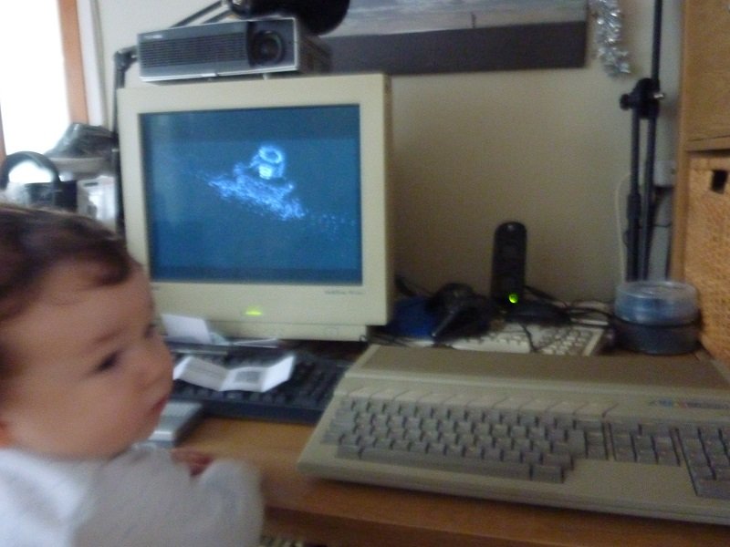

And here we are, all safely delivered and re-installed at home (very hastily, I might add):
Just keeping this little critter occupied (currently watching the Hmmm... demo) was worth the price! :lol:
(Sorry about the blurry picture; too many 'sticky paws' on the lens I'm guessing. I wonder who would have done that?)
Many thank Steve! Just made my Christmas!! :thumbup:
