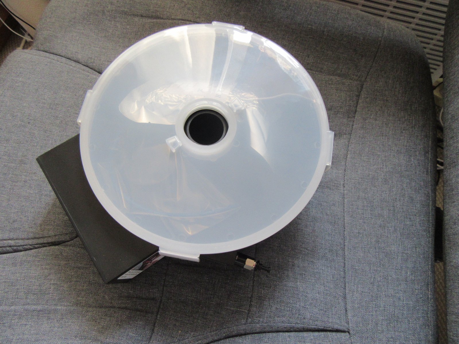

THE SPOOL HOLDER
I really like the enclosed box as it will help keep the filament dry et it also has a space for a "silicon dry bag" thingy at the bottom of the box which is cool. The box looks well made and seems big enough to support my larger reels (not yet tested as I am using the smaller sample reel which came with the printer currently) .
However, trying to figure out how to physically fit the thing was a monumental challenge :roll: at first glance there are slots in the back of the printer, and then "nubs" on the back of the box. So initially I thought it would just slot together and twist to lock. However it was not that simple!
I then found a more typical looking spool shaft which slotted in the back of the printer. Then I thought "ah-ha" slot the box over that shaft.. but nope.. I was sat puzzling for a while and even puzzled over the manual at that point!
It was basically physically impossible to slot the shaft inside the spool holder container!
I sat puzzling over this for another few minutes and then realised that the actual shaft end un-clips!! :roll: It was totally unobvious and did not seem to be documented anywhere!! :pullhair: :headbang:
So the actual order is to slot the shaft on the back of the printer.. Remove the "slot cap" off the shaft.. Put the spool box on the shaft.. THEN fit the slot cap back on..
:dizzy:

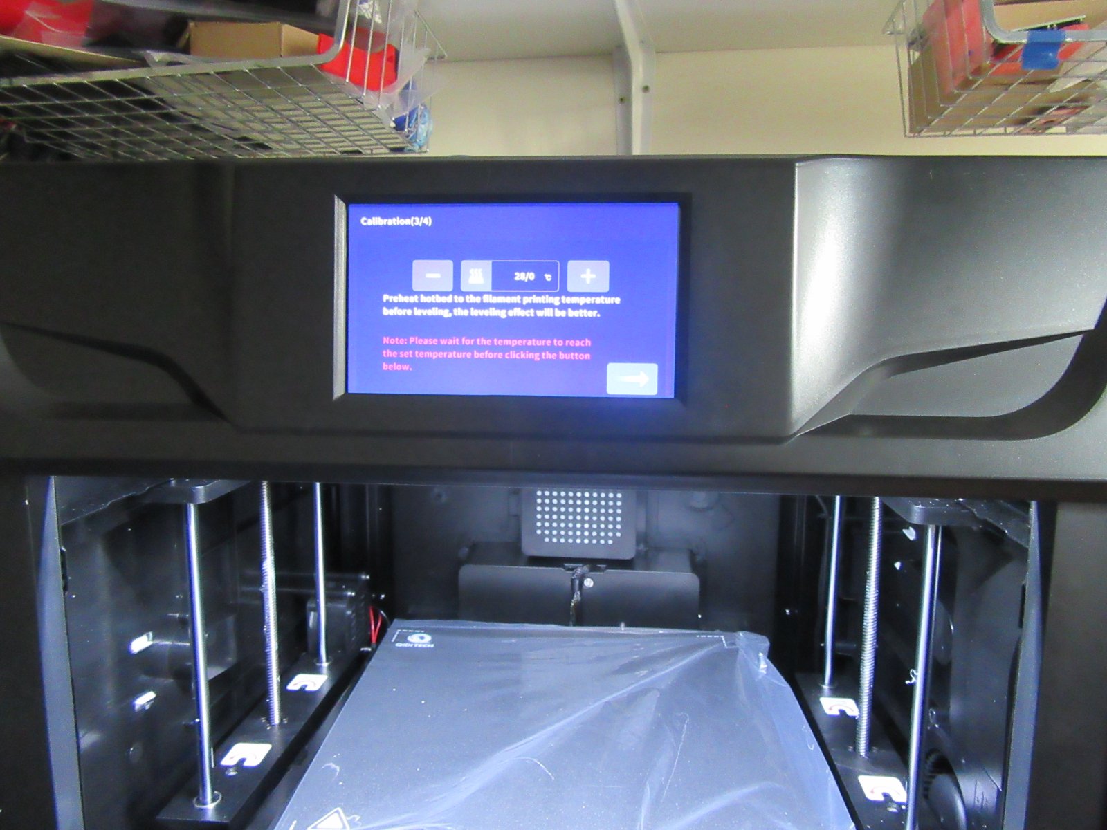

BAD INSTRUCTIONS
While removing all the cable ties is pretty obvious. You cannot actually remove four of them as they are trapped under 4 bolts which screw the bed down during shipping. It wasn't until I started powering up the printer that the on-screen instructions then said to remove the bolts and then the bed would move upwards way you remove the packing foam from underneath.. However it should have really mentioned removing the cable ties at that point as well. As it is physically impossible to remove them until that step.
However at that point, it then mentions to heat the bed up.. but the instruction doesn't make much sense to me..
But also it should have actually mentioned to remove the plastic of the bed at that point in case some idiot like myself missed it...
I don't understand how you can heat the bed to the filament temperature ?! I mean the printer bed is limited to 65c I think, the filament temperature normally 220c ?! I just set it to 50c and carried on..

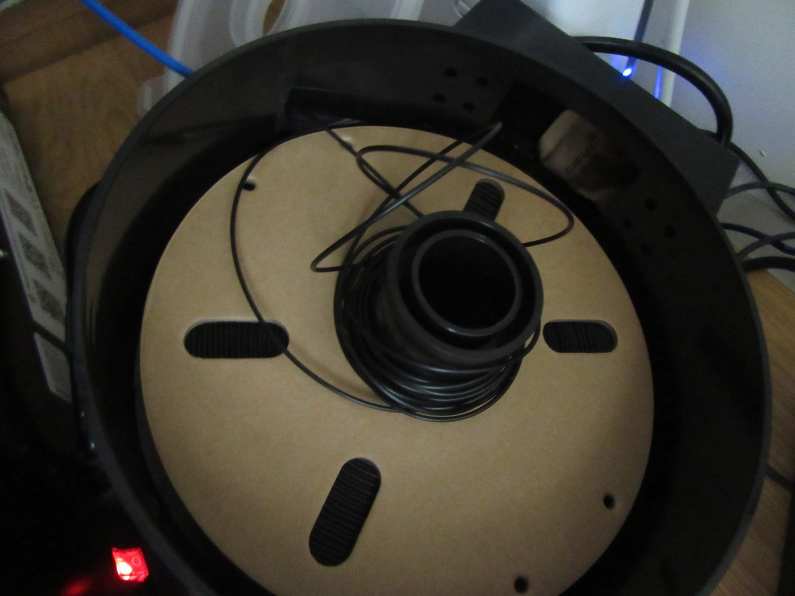

Investigating why the filament was not extruding became quickly apparent! I don't know really how it ended up like this. But I guess it explains why suddenly stopped printing. I don't know if the printer detected no filament flow and the aborted the print before :shrug: It probably explains the "bad print" as well.
Decided to put my larger PTEG stuff in.. As usual, no printer known to mankind seems to accept these reels properly :shrug:
I guess it would be nice if there was some sort of bearing inside to allow easier rotation of the spool. Though I think I will have to go hunting to see if someone already build a spool adapter.. but for now.. lets just get back to printing!!
