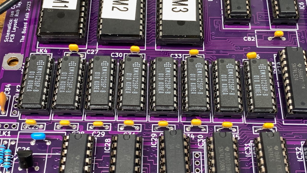

The first thing I'm going to do is swap the chips in the lower and upper banks of memory to try to rule out a bad chip. It's quick and easy.
Posts: 7492
Re: New project: Repro Camputers Lynx
Some major progress this morning.
I tried swapping the RAM between the upper (video) and lower banks: No change.
I tried swapping the lower RAM with different 4164 RAM (mix of 150ns and 120ns): No change.
I tried swapping out the CPU with one marked as being faster in case it was a clock rate issue: No change.
All this RAM was TI stuff so usually bulletproof.
My theory at this point was that the RAM was too fast and the system wasn't refreshing quickly enough.
/RAS and /CAS on the chips all looked good. Better on the upper, video, RAM but sufficient on the lower.
I was about to give up but found a cache of 80ns 41256 chips. I wondered if the problem would be worse with these chips...
Note that they are not TI chips...
Well, erm, the machine works now and is stable. No crashing or reboots. I've had it running for-next loops for half an hour now.
I still have TI chips in the upper RAM but that seems fine.

I'm now using TM4164-15 chips in my "ram" bank without issue, so it's odd you're having issues with them but I'm running at 4Mhz right now.
Posts: 7492
PhilC wrote: Wed Apr 08, 2026 1:59 pm I'm now using TM4164-15 chips in my "ram" bank without issue, so it's odd you're having issues with them but I'm running at 4Mhz right now.
But you have an original machine with the "correct" combination of 74xx, 74Sxx and 74LSxx parts, which have different timings. Mine is all 74LSxx which will skew things slightly.
