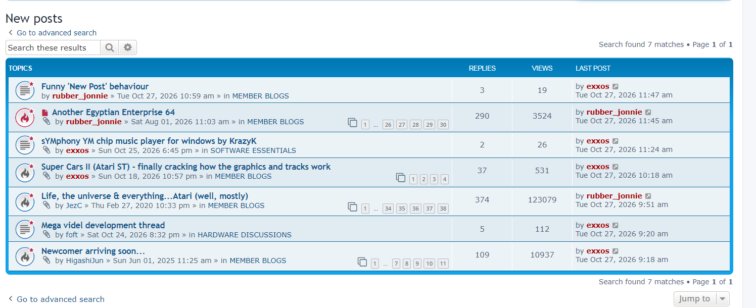

This is what I currently see and read posts are still in list about three hours later.

That matches what I see, but by now it would usually have cleared.exxos wrote: Tue Oct 27, 2026 11:49 am This is what I currently see and read posts are still in list about three hours later.
