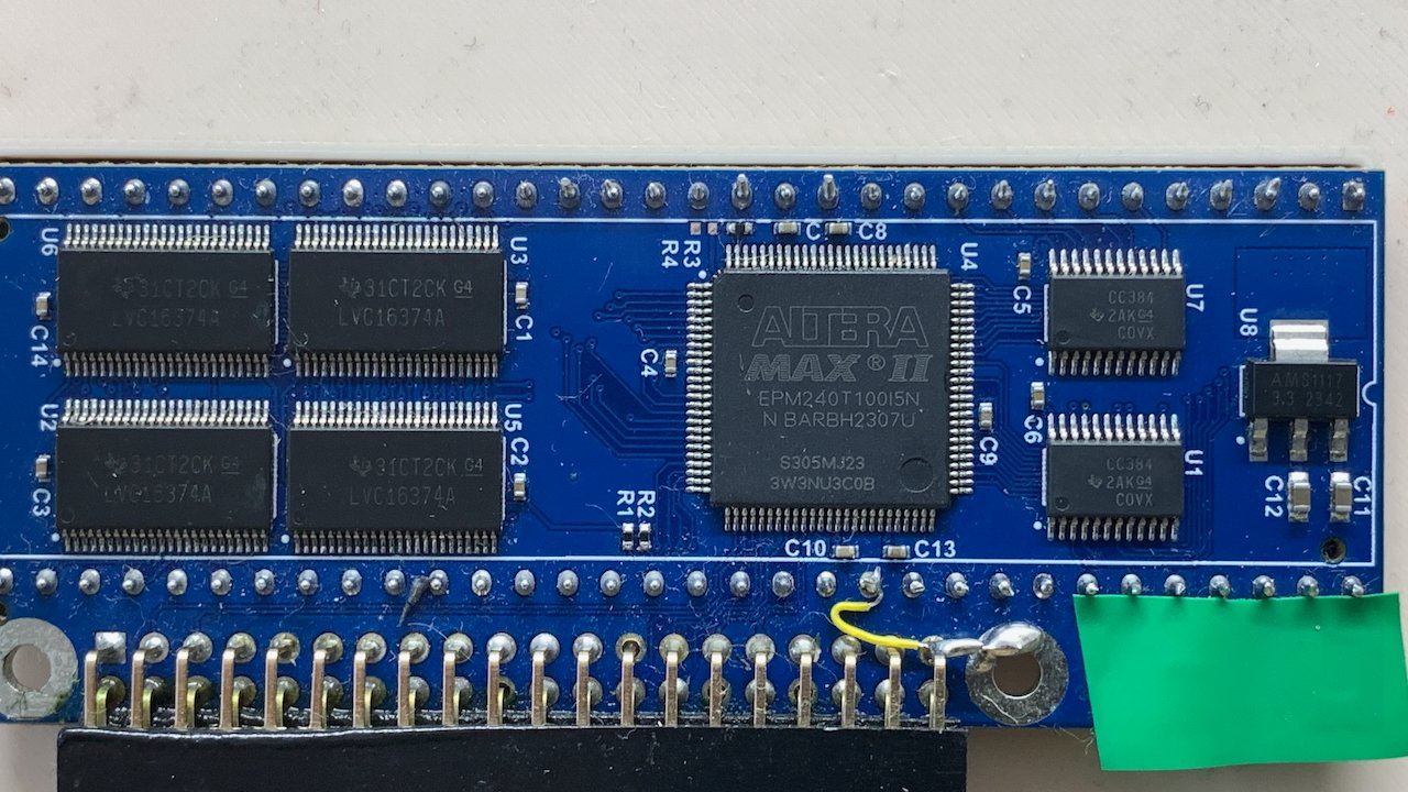

Just a note that not all A500/A2000 PiStorm board work. My original one was just too slow. Although it worked fine in an Amiga it just couldn't keep up with the needs of the Atari bus. @dad664npc has kindly loaned one of his for the time being and I have a new one hopefully arriving today. Fingers crossed that this new one works.
So, if you try this current firmware and emulator and you always get memory errors in the ataritest test program then look first at your PiStorm adapter board and not the ST or the Pi.
P.S. this is the board which doesn't work, and it's not technically because it has xxx374 latches as they work on other boards. Maybe it's a slow CPLD???
