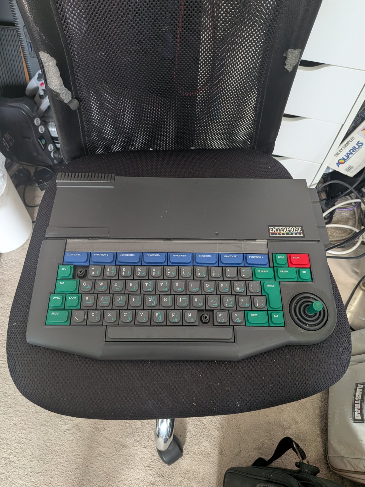

Egyptian Enterprise 64 number 2
- Posts: 15548
It's here!!!
More to follow...
More to follow...

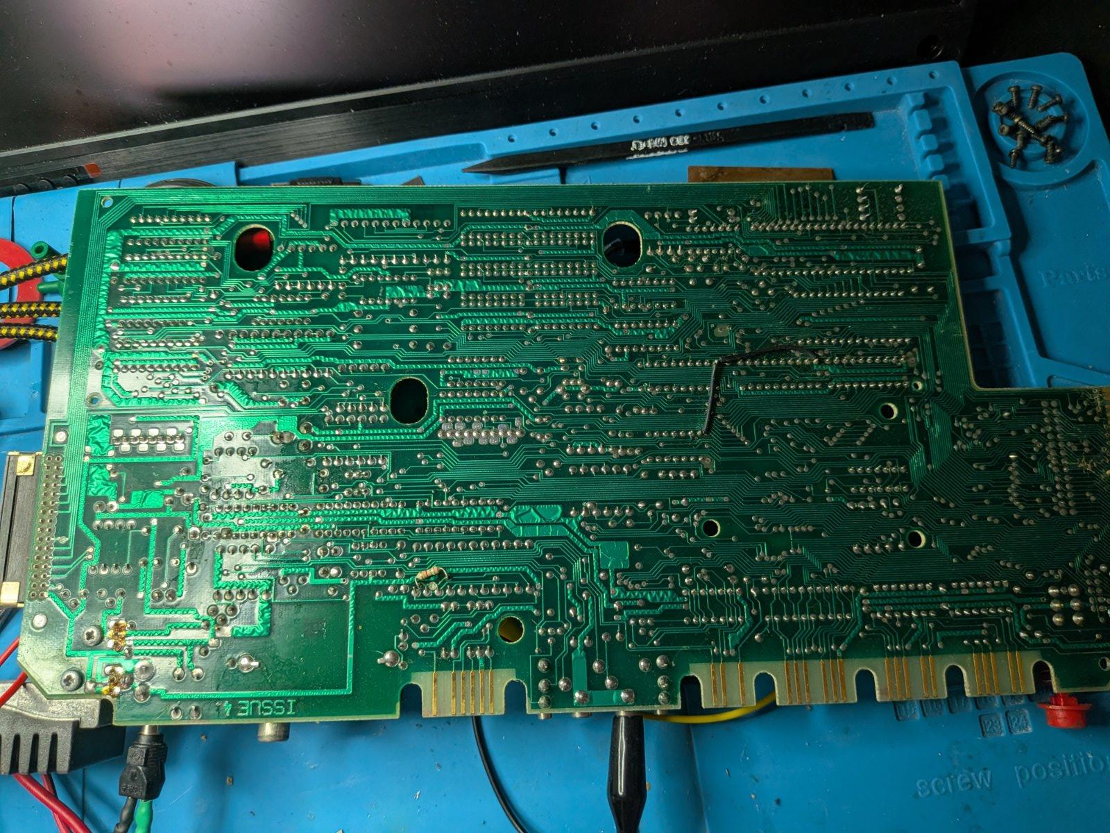

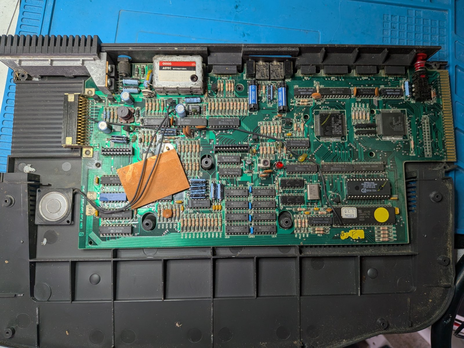

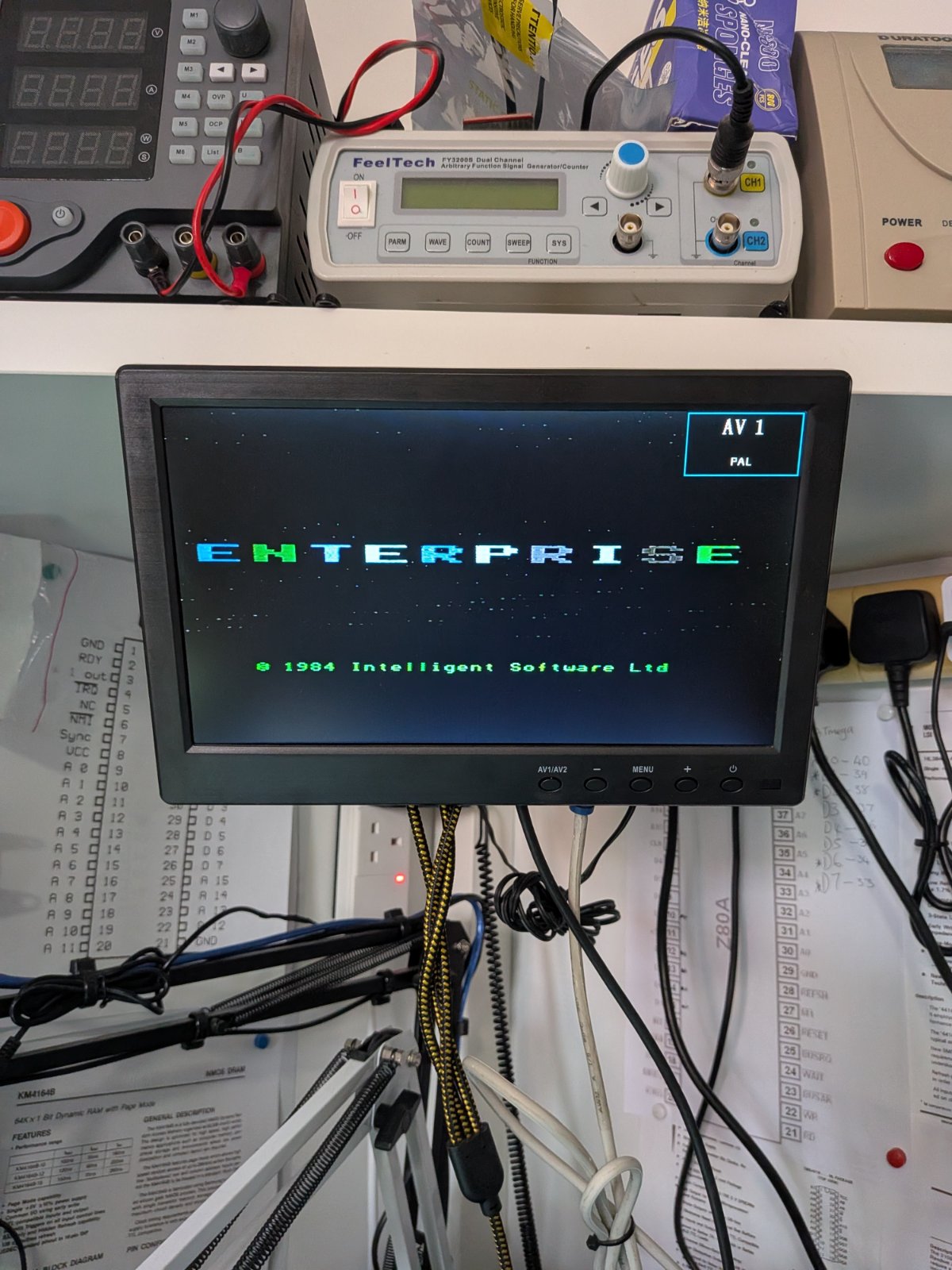

So all stripped down and I was right about the heatsink for Nick, it was floating around...
It's a little dusty inside, though much better than my other one:
However overall it's in much better electronic condition than my other machine.

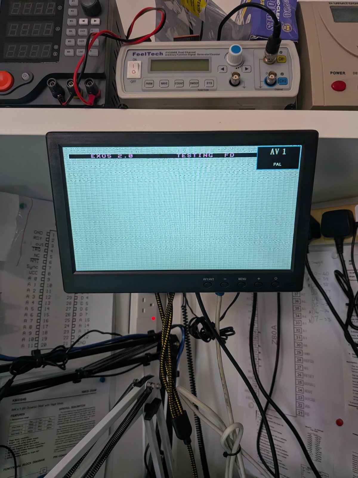

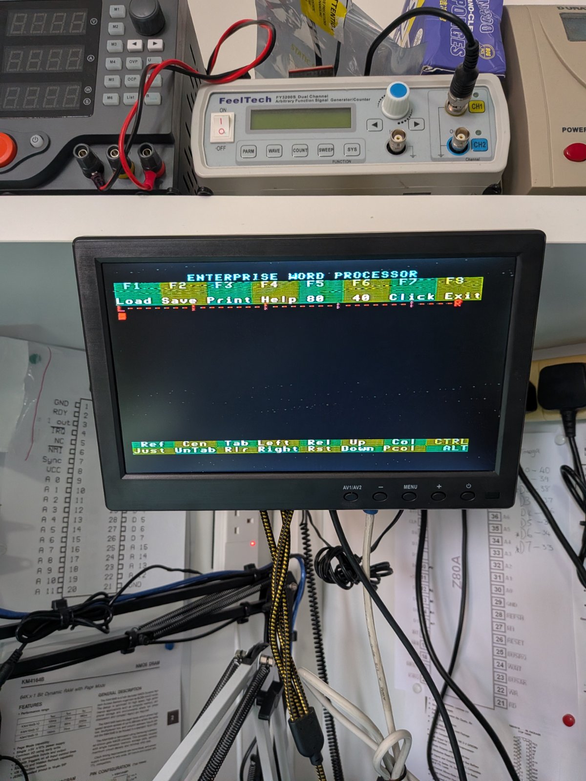

It boots:
So it'll be getting a ROM upgrade once I clean it up a little and re-fit the Nick heatsink. Hopefully the Z80 in this one won't be dead and hate ram expansions...

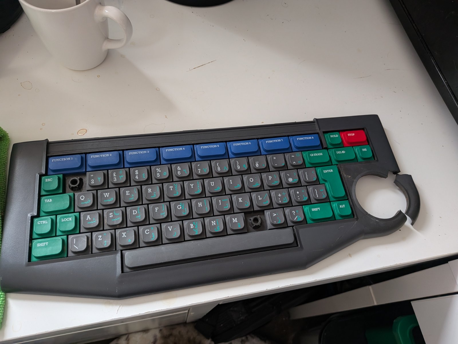

The only problem area is the case around the joystick, which is fine when assembled, but not when it isn't...
However I have no worries that I'll be able to get it up and running and have already got new keys in (Though they aren't quite the right ones they firt
So looks like this is going to be more of a physical resto then electronic
Also, so far, TR2 hasn't blown up, which is a good sign.

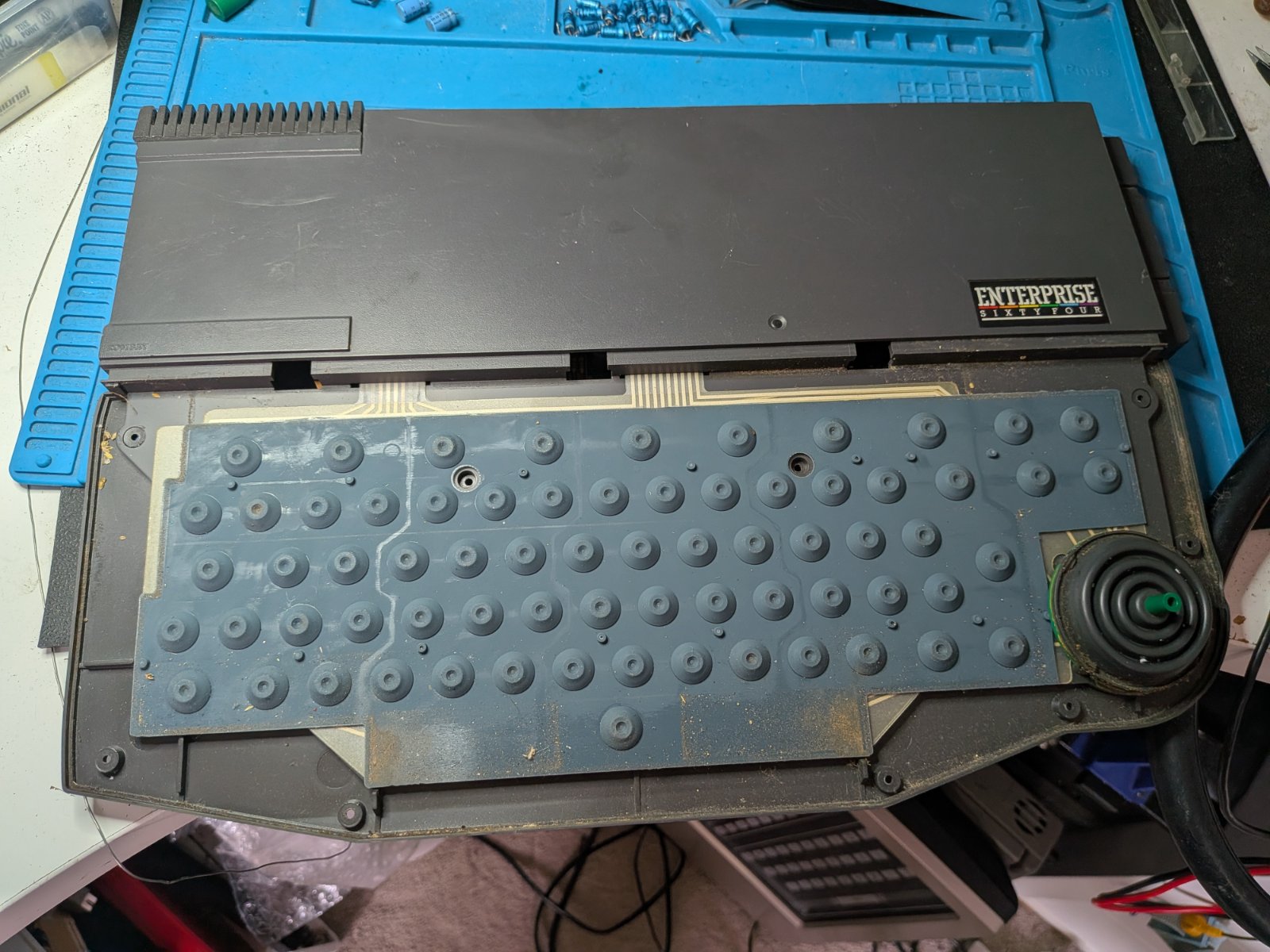

Keyboard membrane seems OK, however I will reserve judgement until later.

Well it's working as you can see from my previous post, but needs some TLC on the case.alexh wrote: Mon Oct 19, 2026 1:29 pm Was the one you had just a little bit unreliable? Or this one just too good a deal to pass up?
Looking forward to seeing if you get it working and which one you keep.
I'll likely be keeping both, it was a good price and I feel these machines need to be kept running for posterity

And in news that everyone expected, the keyboard membrane disintegrated like a pice of rice paper baked for an hour at 200C...
