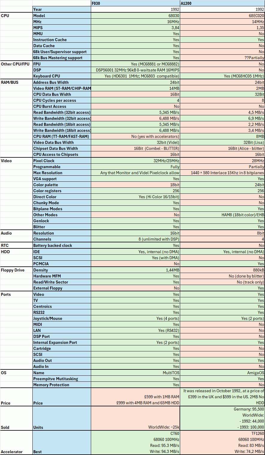

attached my Atari Falcon vs Amiga 1200 comparison.
I need to review and correct a few things.

While you identified the weakness of not having a 32 bit bus and not having fast ram, there's also the issue of running with only 16 MHz on that 16 bit bus (which gets even more ridiculous when you see that Motorola at the point didn't even sell those; as far as I know the Falcons have all cpus that could have been run faster - at least in mine from 1992 it already came with a faster cpu which was underclocked).
Then there's the flaw of doing only the 16 bit mode as chunky graphics mode but not the 8 bit mode (which would have made it easier to port or write the kind of games that all the PC guys were already enjoying and was already available and supported in 3rd party cards for the TT and MegaSTe). Given the performance and capabilities of ATARI's blitter interleaved planes mode was not the best idea - I remember having a talk with ATARI's Bill Rehbock at CeBit 1993 where he basically hinted at "if there's a future machine, then it will have chunky graphics", but that never came to fruition.
Biggest disadvantage of the Falcon compared to the Amiga 1200 however was its price (double of the Amiga). It might have been worth for some people who made use of the DSP or invested in the "future potential" of the machine (rarely a good idea :)), but that was a minority of people as it turned out.

The A1200 motherboard has a place for an FPU but it isn't fitted from factory and because it is surface mount QFP it's hardly a simple user install.

I believe the aux port was forgotten on the Falcon board above
Great comparison!
What I have noticed:
My upgraded Amiga 1200, with an 68030 running at 28MHz with 16MB Ram, when running resolutions equal to or higher than 640x480 is very slow compared to stock Falcon with 14MB RAM running the same or higher resolutions.
The Falcon when running Magic is considerably faster than the Amiga even at resolutions as high as 1024x768x256 colors for windows open/close/move and file operations.
I had read somewhere that the access to the Amiga 1200 chip ram is 16bit but I have not confirmed it.
Finally, I believe the Falcon with a CPU upgrade such as the DFB1(X) and a proper amount of ram, will be considerably faster than an equally upgraded Amiga 1200 (possibly due to chip ram).
If I recall correctly the Falcon blitter can also access fast ram so this is something than can further help the Falcon.
Amiga OS or hardware has limits to partitions access which kinda block both the disk partitions size or the partitions number. There have been new file systems able to access more than the limit (cannot recall it) and quite a few gigabytes per partition. My experience is that the file system is not working well. Maybe my Amigas need recap.
On the Falcon though the 1GB is easily passed and especially with Magic (have not yet installed MiNT) and works without issues even on partitions as big as 30GBs.
Both are very slow though on big partitions -Falcon is a tad faster and more reliable IMHO

MegaSTEarian wrote: Mon Oct 05, 2026 9:47 pm My upgraded Amiga 1200, with an 68030 running at 28MHz with 16MB Ram is slower, when running resolutions equal to or higher than 640x480 is very slow compared to stock Falcon with 14MB RAM running the same or higher resolutions.
Possibly a software setup issue?
MegaSTEarian wrote: Mon Oct 05, 2026 9:47 pmI had read somewhere that the access to the Amiga 1200 chip ram is 16bit but I have not confirmed it.
CPU access to ChipRAM on A1200 is 32-bit as is Lisa the gfx chip. Some DMA devices, e.g. Blitter, Paula etc are still 16-bit
MegaSTEarian wrote: Mon Oct 05, 2026 9:47 pmAmiga OS or hardware has limits to partitions access which kinda block both the disk partitions size or the partitions number.
Fixed decades ago.
MegaSTEarian wrote: Mon Oct 05, 2026 9:47 pmThere have been new file systems able to access more than the limit (cannot recall it) and quite a few gigabytes per partition. My experience is that the file system is not working well.
Fixed decades ago. FFS with AmigaOS 3.1.4+ is much better and PFS3 or SFS even better. Today FAT32 and NTFS are also fully supported (with a custom ROM)
MegaSTEarian wrote: Mon Oct 05, 2026 9:47 pm Maybe my Amigas need recap.
You just need to update the software on them?

pixelpusher wrote: Mon Oct 05, 2026 6:56 pm Biggest disadvantage of the Falcon compared to the Amiga 1200 however was its price (double of the Amiga).
Hmm, I'm not sure about this - maybe it depended on location?
When I bought my first Atari Falcon 030 it was $799.00.
Same year, when I bought an Amiga A1200 it was $599.00.
Hardly double here. That was both machines with no hard drive,
2 megs of RAM on the Amiga and 4 megs on the Falcon.
