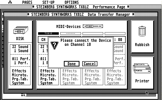

You can choose your DX/TX synths and their midi channels in the Data Transfer Manager. It’s the opening screen of this program.
But here the trouble begins. All the time you get the message: ‘Please connect the Device on Channel X’ And no matter what you do, this message will repeat until you hit Cancel twice. I’ve tested this program on my STe, MegaSTe and STeem. I’ve tried all settings, changes and midi channels, switched bulk dump protection off... Every time I’ve got the same result below.

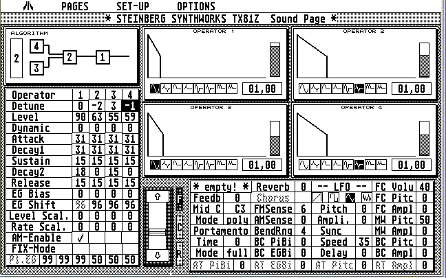

The TX81Z has two modes: Single and Performance. The Sound Page is the page where you do most of the programming needed to create or change a sound in Single mode. If you want to edit a multi-timbral set-up you go to the Performance page.
Fantastic Sound Page
Unlike Synthwork versions for other synths, the TX81Z editor works in a GEM environment. The program is mouse driven. Left and right mouse clicks increase or decrease numbers. Some pages show a kind of mod-wheel to change values. Three knobs besides this wheel allow making precise adjustments. It’s also possible to type in values.
The Sound Page is a dream to work with: easy and intuitive. Yamaha’s user manual has only one big fault: it doesn’t show the 8 algorithms. This Steinberg editor shows pictures of the algorithms. Making it very easy to understand what you’re doing.
Another strong point of the Synthworks Sound Page is the way the Operators are made visible. You see the four operators on one screen. So you don’t have to switch between them, which is annoying in other editors. You can shape each ADSDR-envelop with the mouse. That’s a lot easier then filling in numbers.
Do you want another waveform? Just click on the icons representing the waveforms under each operator. Just one critical remark: it would be nice if Synthworks pointed out whether an operator is carrier or modulator, like freeware YSEditor does. All other operator parameters are on this page too, so are the LFO settings.

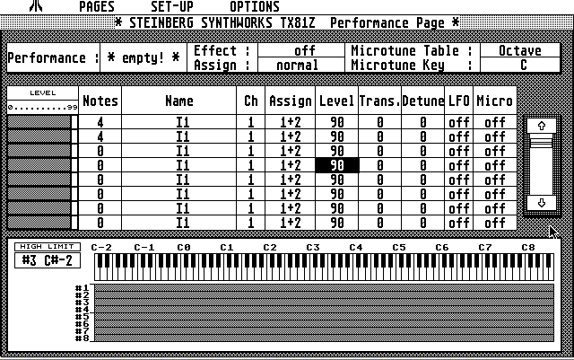

In the Performance Page you make the multi-timbral settings. This Yamaha is a very flexible instrument. You can have maximal eight voices on eight different midichannels, or make a split keyboard setting on just one channel. Or make combinations of both possibilities: a drumkit on one channel using the split keyboard. And bass and other sounds on different midi channels. You can layer sounds too. With some detuning and panning this can produce some really ‘phat’ sounds. This page really speaks for itself. A very nice and modern feature is the way you can layer/ divide the sounds on the screen keyboard. Just use the mouse to draw your note settings.

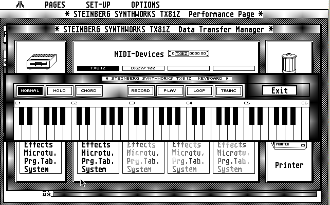

The Keyboard Page speaks for itself. Users can also play sounds on the number keys (above the letters) of their Atari keyboard.

And now comes the bad news. I’ve told you already about those messages ‘Please connect the Device on Channel X’. And that whatever I did, I couldn’t get my settings accepted. The consequences are that the Librarian function doesn’t work. Sending and receiving single presets or banks between Synthworks and the TX81Z seems impossible. This effects the following pages: Data Transfer Manager, Sound Memory Pages and Performance Memory Page.
The full version of this editor allows you to exchange sounds between the synthesizer, the provided Steinberg sound banks on disk and the Temporary Bank. But I didn’t succeed.
Because of that omission, this crack is only usable if you want to program your sounds or performances from scratch. And if that’s what you want, I haven’t tried a better editor than this one.
