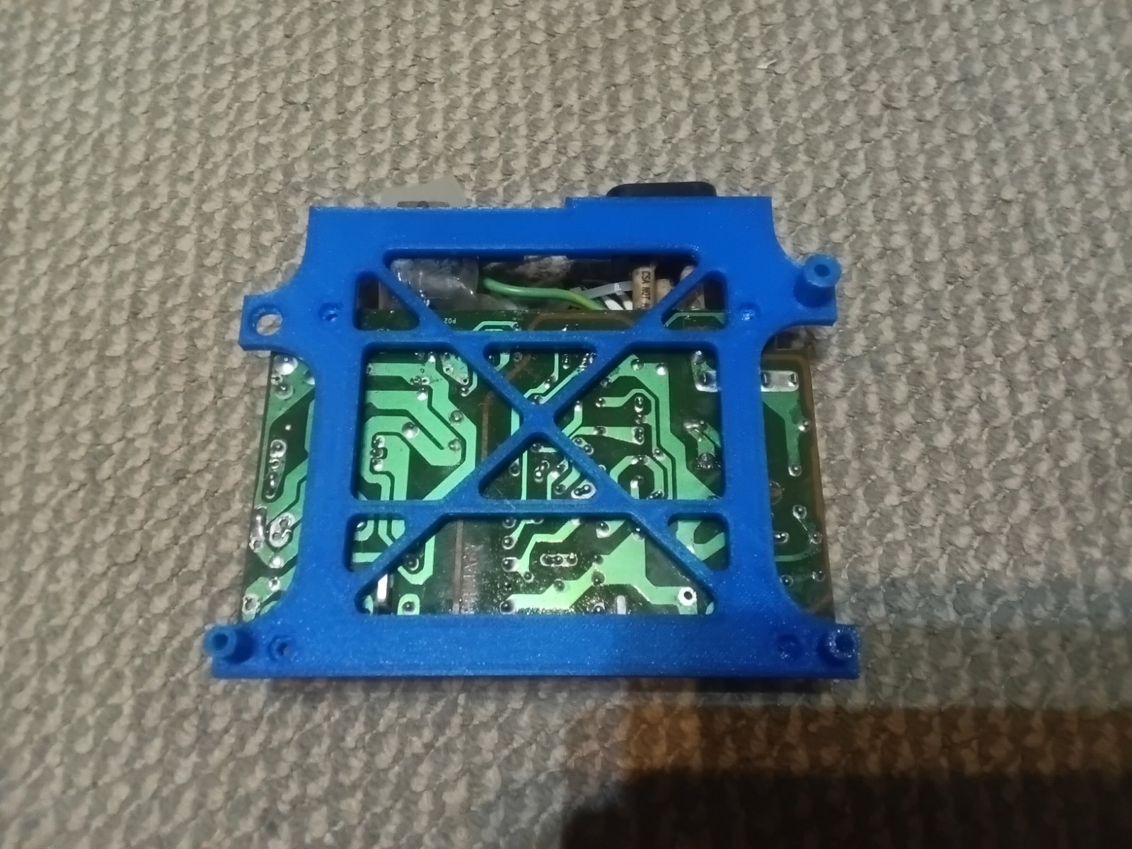

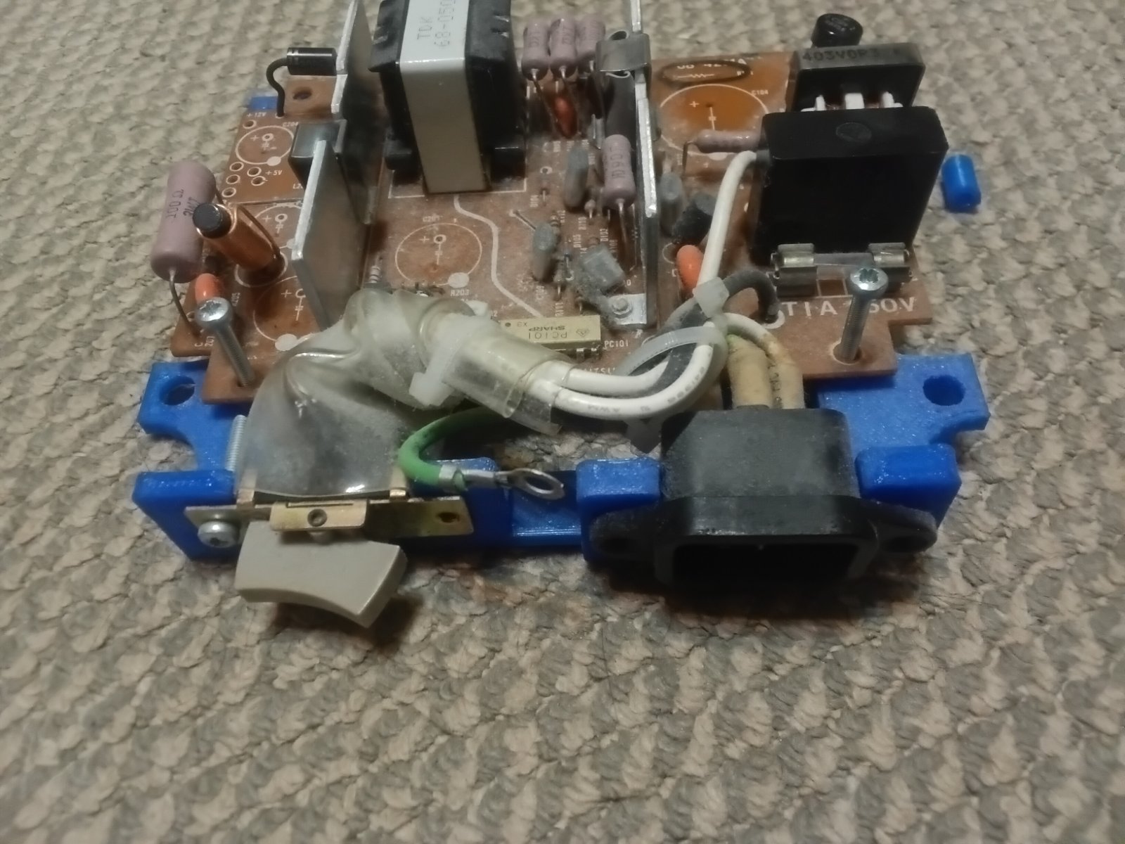

This was my STF psu bracket I made years ago..
Would of course, need modifying to fit the Falcon, but most of the work I think is already done anyway.
