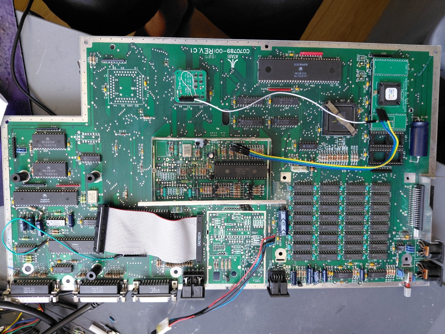

Hi all, I require your expertise because my STF is killing me. I have an MB C070789-c1, and I installed the dual TOS with a decoder. It was working almost fine, so I decided to apply all the fixes suggested on the EXXOS forum. Everything was fine until the last one to solve the 10K nightmare.
Unfortunately, other than replacing all the SIL, I also removed the TOS sockets to lower the Dual Tos board. I wish I were clever enough to do one mod, test and then do the second, but I didn't. Now I find myself with a white screen when I turn the STF on. I checked the following:

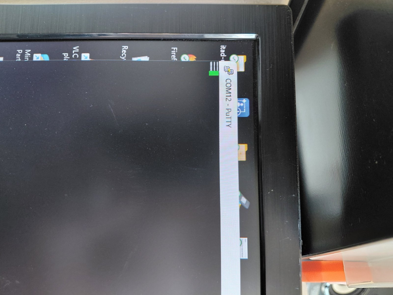

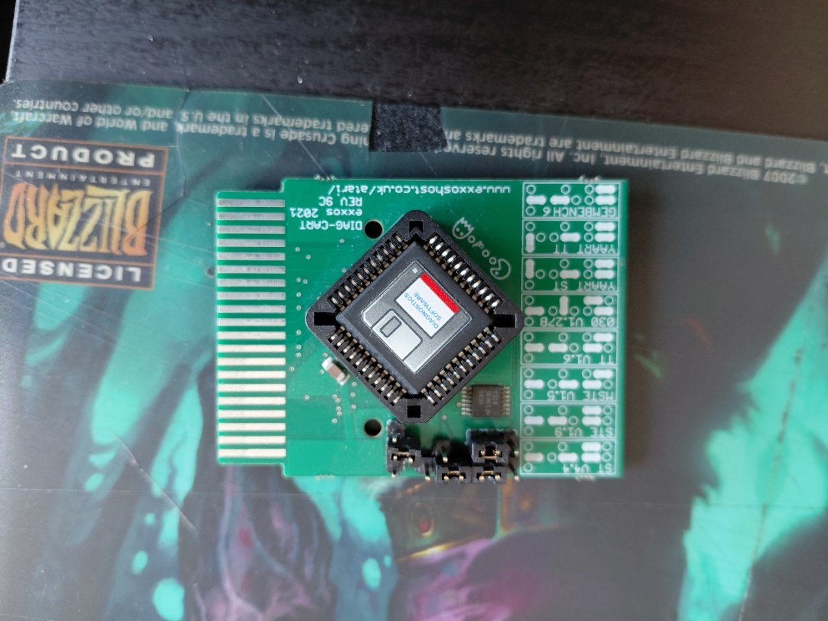

I also used the EXXOS test cartridge, but still no video. And using a serial cable, on my terminal, only a weird character appears (see image).

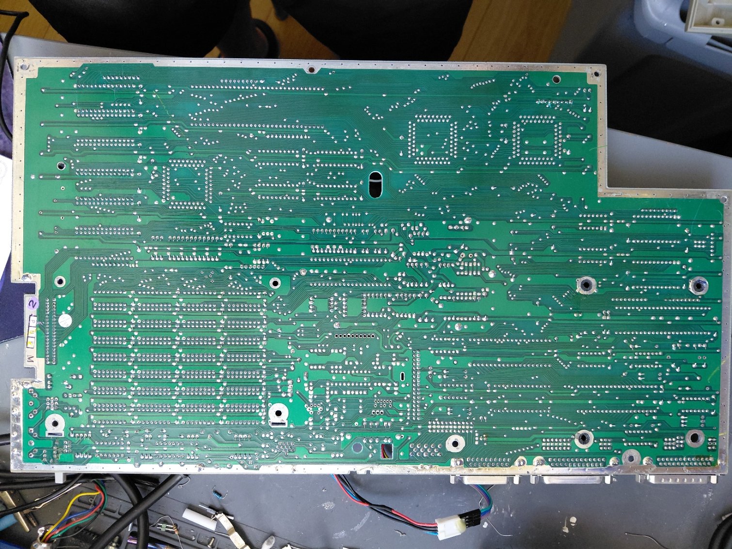

I have attached a few images of the MB, the Test cartridge configuration and the terminal output.

Quick question: does the diagnostic cartridge replace the TOS when you insert it, or does it work with it?

It sounds to me the problem started when you removed the ROM sockets and soldered the ROM board in directly ? Most probably you have a broken track or via. So you would need to continuity check between the ROM pins and the CPU..
Also note when you are testing things on your scope, of course need to be testing on the chip in itself, also be aware that pressing down on the pin could actually make contact and give the appearance it is working.. When you remove the probes the temporary pressure you put on the pin is now gone and you can end up with a open circuit.. The need to be careful when taking measurements and continuity checking..
Also note Atari motherboards do not like manhandling at all and you could have completely other unrelated bad joints which have appeared on the CPU or other chips on the board while doing all the work.
Normally a good diagnostic step is to press down on various chips on various parts of the motherboard while continuing to press the reset button to see the springs into life. You can also hold the motherboard in the centre with your thumb, and gently bend upwards each corner of the board one at a time also are pressing reset to see if that makes anything spring into life. Generally doing those techniques you can probably work out a rough area the bad connection is assuming you have one which is intermittent..

Yes, I think you have found it. If U67 pin 2 has no continuity to U63 pin 2 or to CPU pin 41, then the low ROM has no A13. Half the ROM space will read garbage on the odd bytes, so TOS never gets off the ground. That's your white screen.
It also explains the 60Hz. The machine powers up at 60Hz and it's TOS which switches it to 50Hz, so if TOS isn't running it just sits at 60Hz. Same reason swapping back to the original ROMs made no difference: the ROMs are fine, the board isn't.
Your table looks correct to me. The address lines being shifted up by one is right, as the 68000 has no A0.
The fix is easy enough. Just run a short wire from U67 pin 2 to U63 pin 2 (or to CPU pin 41, whichever is easier to get at). Then recheck continuity from the legs of the chips themselves rather than the pads, so you know it's actually connected and not just making contact under the probe.
While you are there, I would also check pins 1, 20 and 22 on both ROMs. In the two ROM setup those are not unused pins. They go through the ROM config jumpers on the board, and as they were right next to the sockets you removed, they are just as likely to have taken a knock. Check them against sheet 4 of the schematic.
As for the diagnostic cartridge, it doesn't replace TOS. The CPU still has to read the start-up code from the ROMs first, and then TOS hands over to the cartridge. So with a broken ROM bus the cartridge won't run either, which is probably why you only got junk on the serial terminal.
