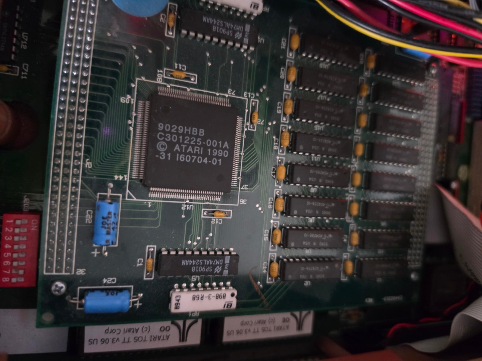

leech wrote: Wed Sep 23, 2026 8:37 am One thing I should ask people... how hard is it to upgrade my ST RAM card to handle 10mb of RAM?
Depends if you have the SMD RAM varient or not. If it's SMD you simply use a heatgun to swap the memory chips and then change a jumper. The through-hole version is more difficult and requires a special daughter-board designed by Lynxman.

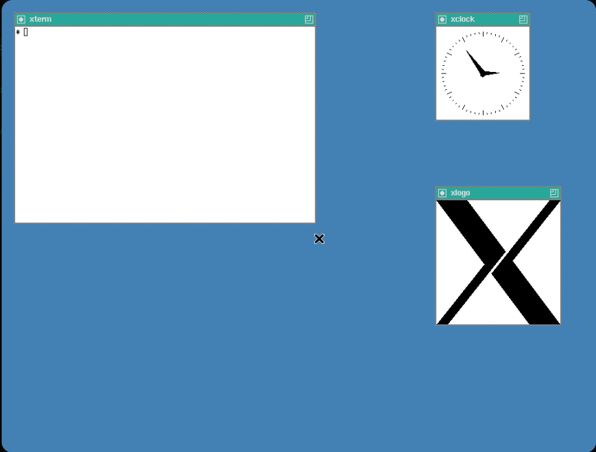

What's really funny? It comes with telnet... so as soon as it finished writing the network driver (which was awful to deal with, since I had to keep swapping the SD Card over to the ZuluSCSI, have it boot up, take a picture of the errors, send it to the Claude app, shutdown the TT (cleanly, so 'shutdown -y -g0 -i0', yup, memorized that one fast), and then move it to the laptop so Claude could modify some stuff... then back to the TT and wait the few minutes it takes to boot..., take some more screenshots...
Talking to the people working on updating Amix, and they had a cross compiler, which is making things much easier than having Claude telnet in and compile things on a 32mhz computer...
Screenshot is running on the modified Hatari...
https://github.com/slaapliedje/hatari
https://github.com/slaapliedje/atari-sysv-sp1
These certainly look like through-holes to me...

Yeah definitely through-hole, you'd need to contact Lynxman on the German Atari forum, he might still be selling the upgrade PCB's.

leech wrote: Wed Sep 23, 2026 9:42 am Screenshot is running on the modified Hatari...
Bravo!
Impressive :yay: :dualthumbup:

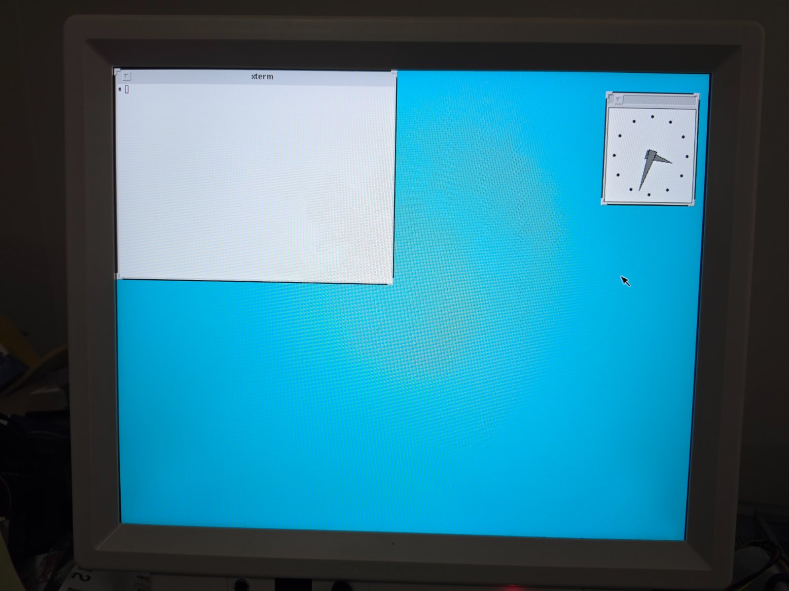

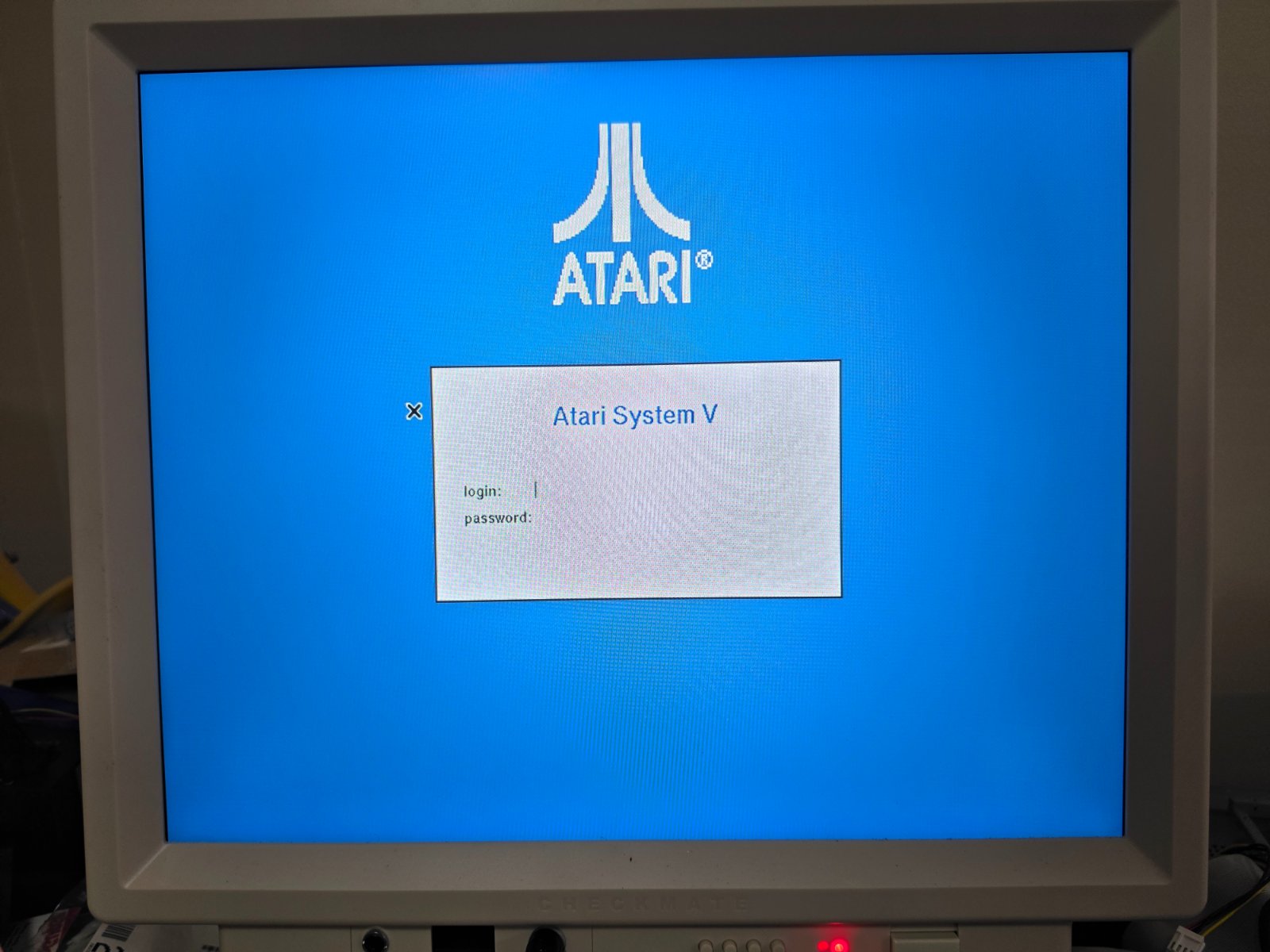

On my TT030 with the ATW800/2 as a display. Going to see what happens when I have claude add in Transputer support...
