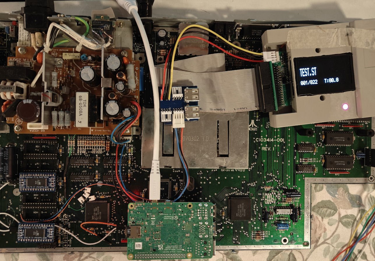

Desolder the old chip. Solder in new. The one I picked here is EDO and they have worked fine since I installed them. But it is not recommended.
The pads for A9 is not connected to anything on the motherboard so you need to connect all of them together. Solder a wire between all of pin 5 on the chips. I did it by going down on each memory bank and then solder it on to the 33 ohm resistor. Then heat shrink tubing over it. Both wire to resistor. Solder another wire on the other leg of the resistor to PLCC MMU pin 64. Heat shrink tubing on that too.
mmu plcc.png (173.44 KiB) Viewed 265 times
RAM soldered in.jpg (209.78 KiB) Viewed 265 times
MAD9 wire soldered top.jpg (399.03 KiB) Viewed 265 times
MAD9 wire soldered angle.jpg (271.47 KiB) Viewed 265 times
MAD9 wire 1.jpg (210 KiB) Viewed 265 times
