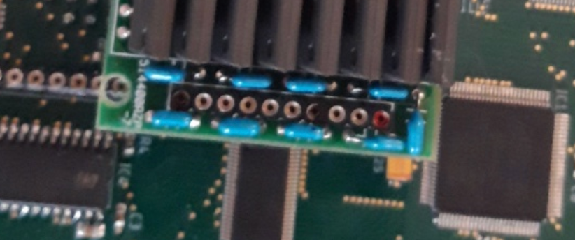

The first thing I did after getting hold of the board was to see if the 8x TRAM-like daughter boards are actually TRAMs at all or if they are custom things which could create special problems figuring out signals etc.
The Transputers have a standard comms protocol but that doesn't mean the boards they are attached to are going to keep to a reference design.
There is local working memory present in zip package format on each board but there are also custom PALS on the boards and on the main carrier.
The most suspect detail is the fact these boards have 20-pin footprint with 10 on each edge while standard TRAMs have a 16-pin footprint with 8 on each edge. They are also 50% wider than a typical single TRAM. That's the first thing needing a closer look.
dml
Posts: 914
Re: Supercomputing adventures with a MegaST/4
Post by dml »
With a bit of patience and a DMM I was able to confirm most of the expected signals are exposed on the inner 8 pins on each row, matching the standard TRAM footprint.
The 4 outer pins are 3 additional GND pins and one additional VCC (I was marking connections out with a sharpie as seen above :p )
So they appeared to be TRAMs with some extra power connections. A bit strange but ok.
I thought about all this for about 18 seconds then decided to stick one in my ATW800/2 to see what happens....

Just wondering, the boards seem to have sockets on top:
Screenshot 2026-08-27 at 11.57.54.png (491.17 KiB) Viewed 282 times
So is it possible to stack the boards one on top of the other to improve density?
If not then why have the sockets at all?
Also, doe this mean you're going to become a TRAM dealer :)
Posts: 3408
rubber_jonnie wrote: Thu Aug 27, 2026 11:58 am So is it possible to stack the boards one on top of the other to improve density?
As far as I know, the cannot stack TRAMS. I *think* the sockets are so you can probe signals easily.
