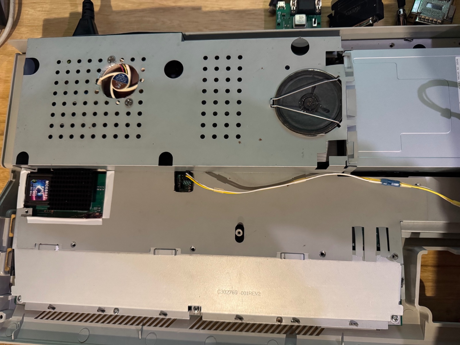

Re: Falcon 030 cooling fan
The only chips in the Falcon that get hot to the touch, in my experience, is the video DAC and the DSP (and DSP RAM) Since I overclock my DSP to 50mhz I actually installed a small fan inside my Gotek which is right above the DSP.
I think I wrote about it here (FYI I cleaned up the cut-out for the fan after taking the picture)JezC wrote: Wed Sep 16, 2026 12:26 pm I'd be interested to see/hear more about those mods at some point... especially as mine has a DFB1X in it as well (and the old toroidal Exxos PSU to minimise heat generated in that corner of the case).
viewtopic.php?t=6304
