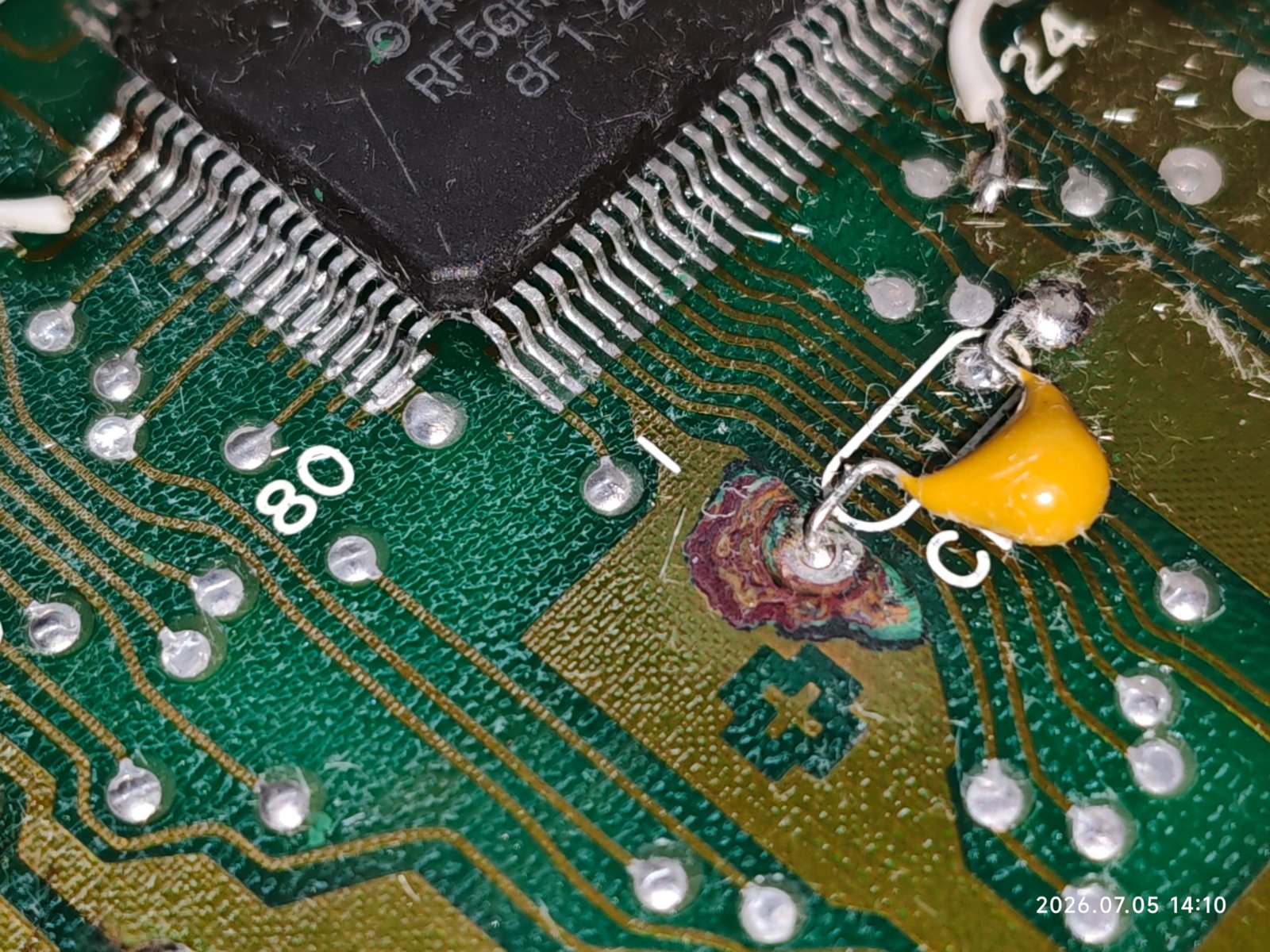

I noticed a leaked (?) ceramic capacitor (C116), replaced it, no changes.

BTW C16 is not electrolytic, so I'd suggest that there may have been some other contamination, maybe a liquid spill because C16 simply can't leak, it looks like some sort of monolithic cap.
You may want to look around further for other signs of liquid damage like that, and possibly consider it may have come from a cap on the Frontier board.
