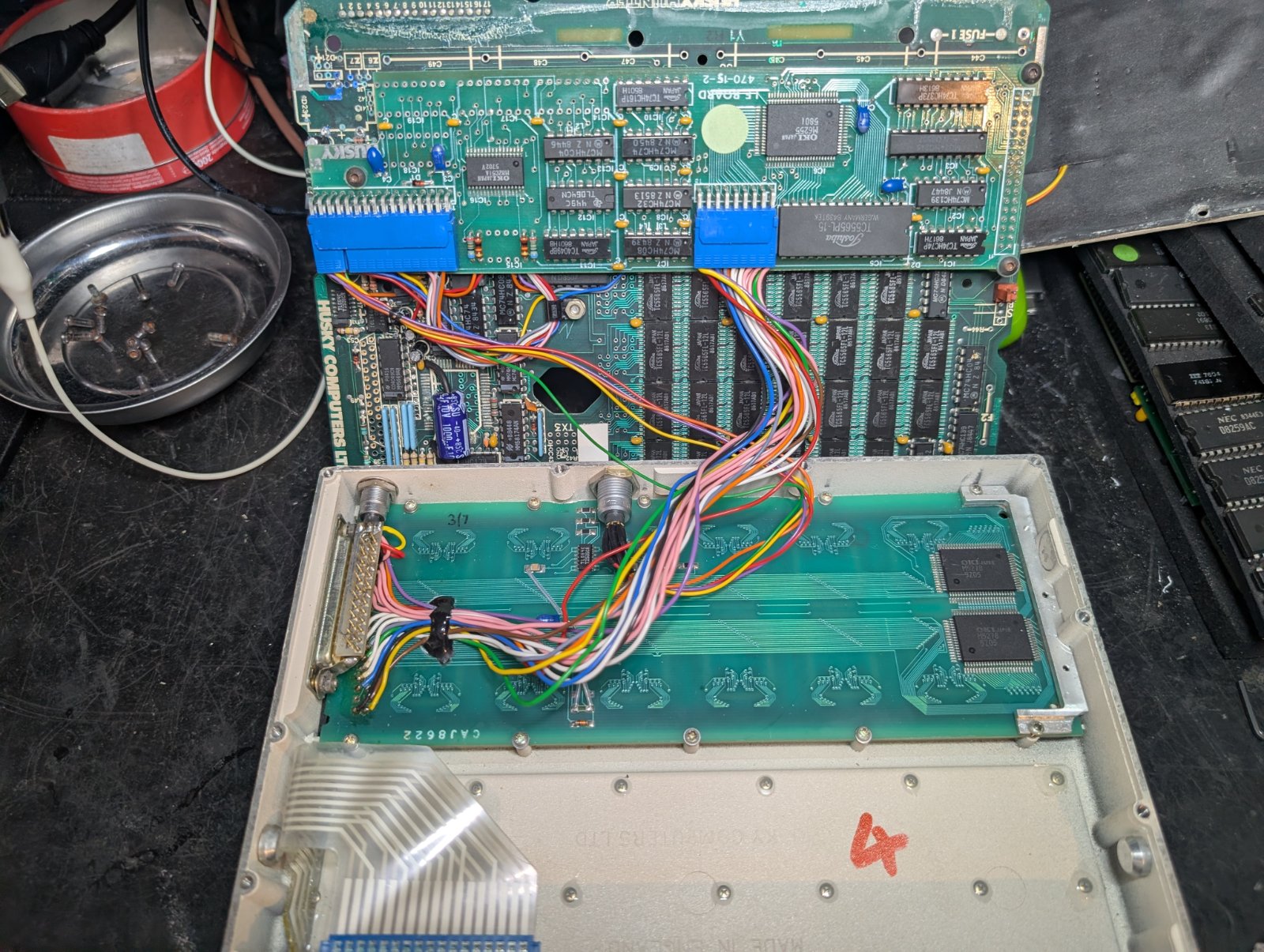

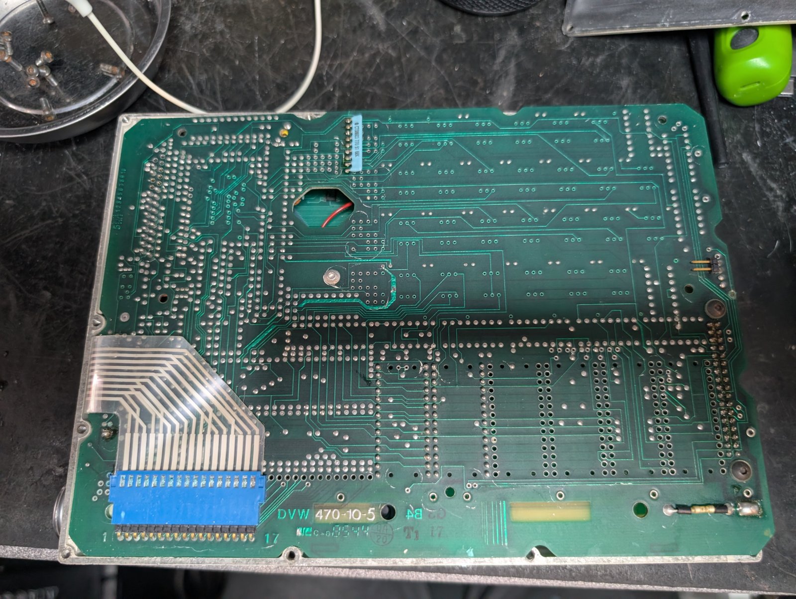

So starting with the Helmsman, it looks to be Husky Hunter but set up to do some kind of navigation, hence the name.
Here's it's internals so far.

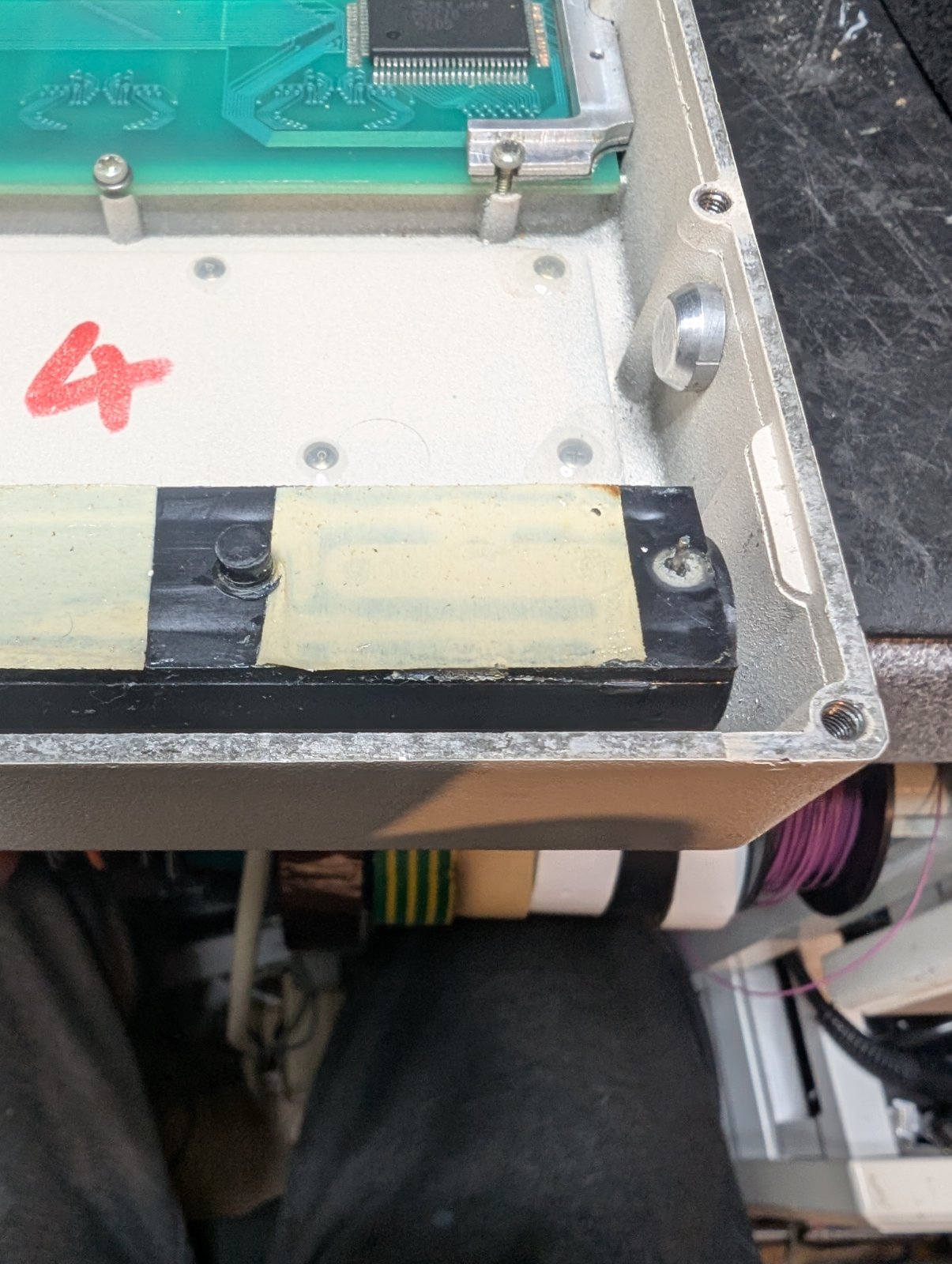

There was a very dry joint on the battery box. Which left it sitting in the bottom when I took the PCB out
It looks like it's got all of its ram bank filled with ram, no idea yet how much that is but will find out soon enough.

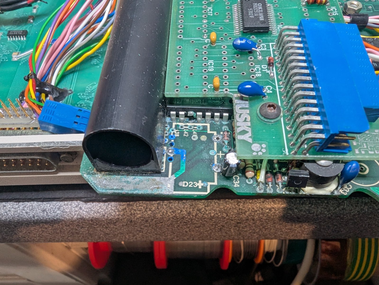

Ok, so it's had it's internal battery removed as well. Without this being present and charged the Helmsman won't function. I'm hoping I'm able to replace this with a rechargeable button cell if some description.

Hmm, things are looking a bit crusty there...PhilC wrote: Thu May 07, 2026 3:35 pm Ok, so it's had it's internal battery removed as well. Without this being present and charged the Helmsman won't function. I'm hoping I'm able to replace this with a rechargeable button cell if some description.
Re: Husky Helmsman & Hawk arrived in the post today.
@rubber_jonnie oh that's not too bad and I should be able to fit a rechargeable button cell in there.
What's slightly more annoying is that someone has removed the LCD display driver from the board. Fortunately you can still get them, it's a HD61830A00 Hitachi dot matrix liquid crystal graphic display controller.
As for the Hawk. Again it looks reasonable inside, so I've ordered a variable power supply for it. Its 6.5V DC annoyingly but the PSU will also come in handy for other stuff. Even more annoying is the fact I put my bench power supply in the loft the other day
