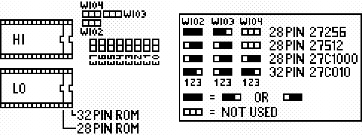

If you don't want to solder the jumpers to select 27C010 EPROM then use 27C1000 as they are the same setting as the original mask ROM.

One thing I do always do with STE's is replace the links (They are just zero ohm resistors) with jumper blocks, but that's entirely your choice and does depend on your soldering skills. You don't want to damage the STE so if you don't have the skills then don't do it.
