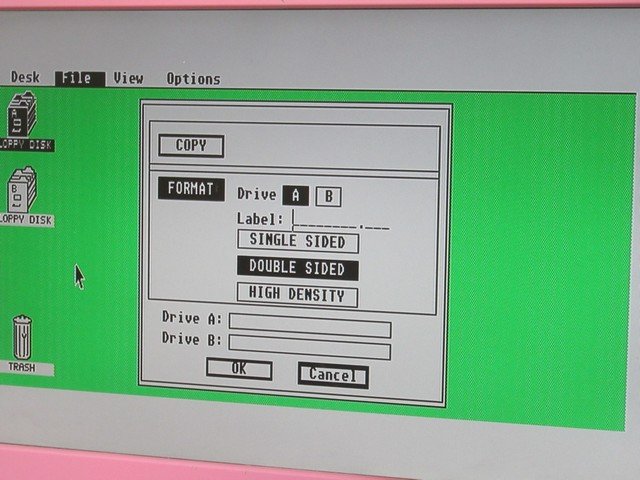

Another question: How can I make the ST recognize HD ? On my Mega STE there's a dip-switch on the motherboard and TOS 2.06 recognizes it and proposes HD options, is there a way to do the same on the Phoenix ?

There is a HD patch for TOS somewhere. It was talked about a while ago but all it really does is enable the HD format option in GEM desktop. It really would be better just to use something like FCOPYIII anyway..

olivier.jan wrote: Mon Apr 06, 2026 3:44 pm Another question: How can I make the ST recognize HD ? On my Mega STE there's a dip-switch on the motherboard and TOS 2.06 recognizes it and proposes HD options, is there a way to do the same on the Phoenix ?
I use a small AUTO folder program from this ZIP file to get TOS v3.06 in my STacy
to show the HD formatting option for my 1.44m HD floppy drive. HTH's. :)

I gave it a try this morning and it works fine. I also tried HD_COOKIE (from this post: https://www.exxosforum.co.uk/forum/view ... =40#p85717) and it also works perfectly, I can read/write and format both 1.44M and 720k floppies seamlessly.

I asked AI if it could write a program to enable the TOS206 HD format option...
:girldance: :girldance:
HDFLOP.zip
(541 Bytes) Downloaded 33 times
AI figured out how to speed up formatting as well. With the ST536, ROM is held in RAM, so simply to patch. So formatting a 720k took 1.40mins, then after a PRG patch, took 1.08mins. So that's a fair bit faster ! But the slowness is because TOS does a verify after each write. Takes ages, but likely better to have it there anyway.
