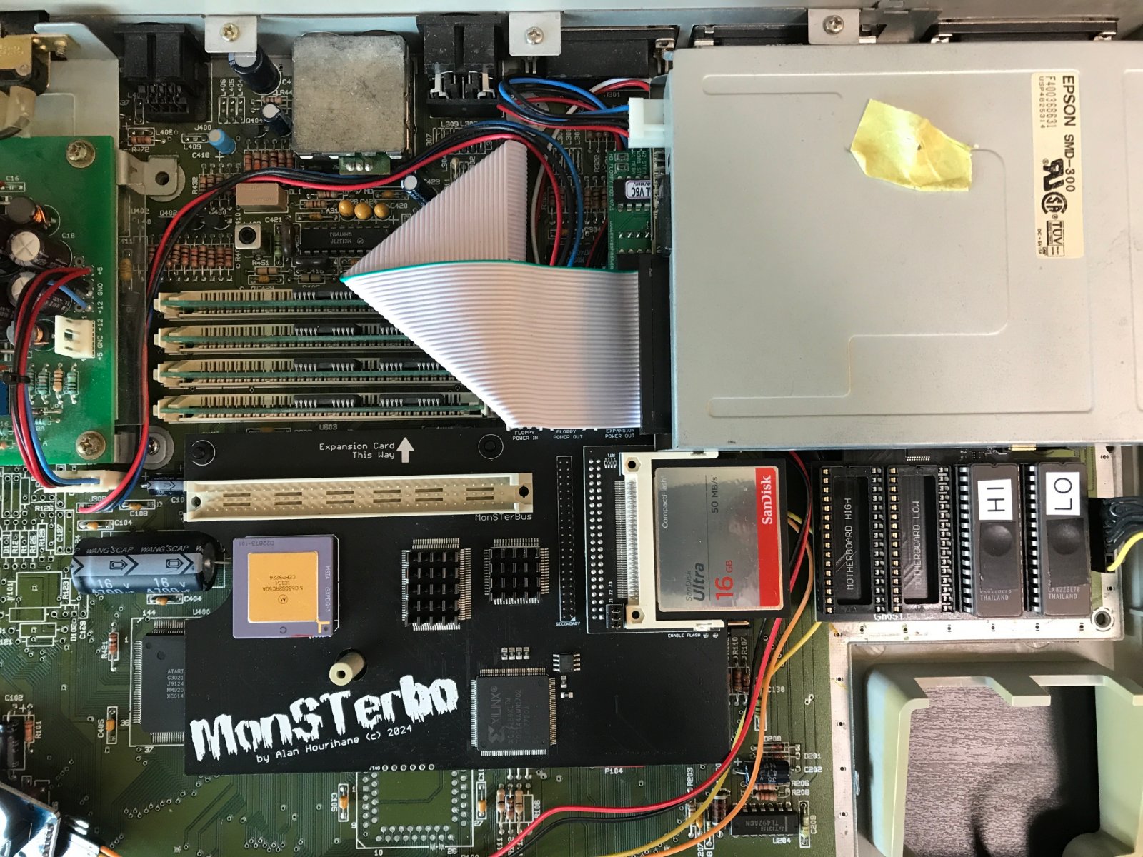

Since I have an STE with a MonSTErbo fitted inside and the board has a "MonSTEr bus", I wanted to make use of it somehow.

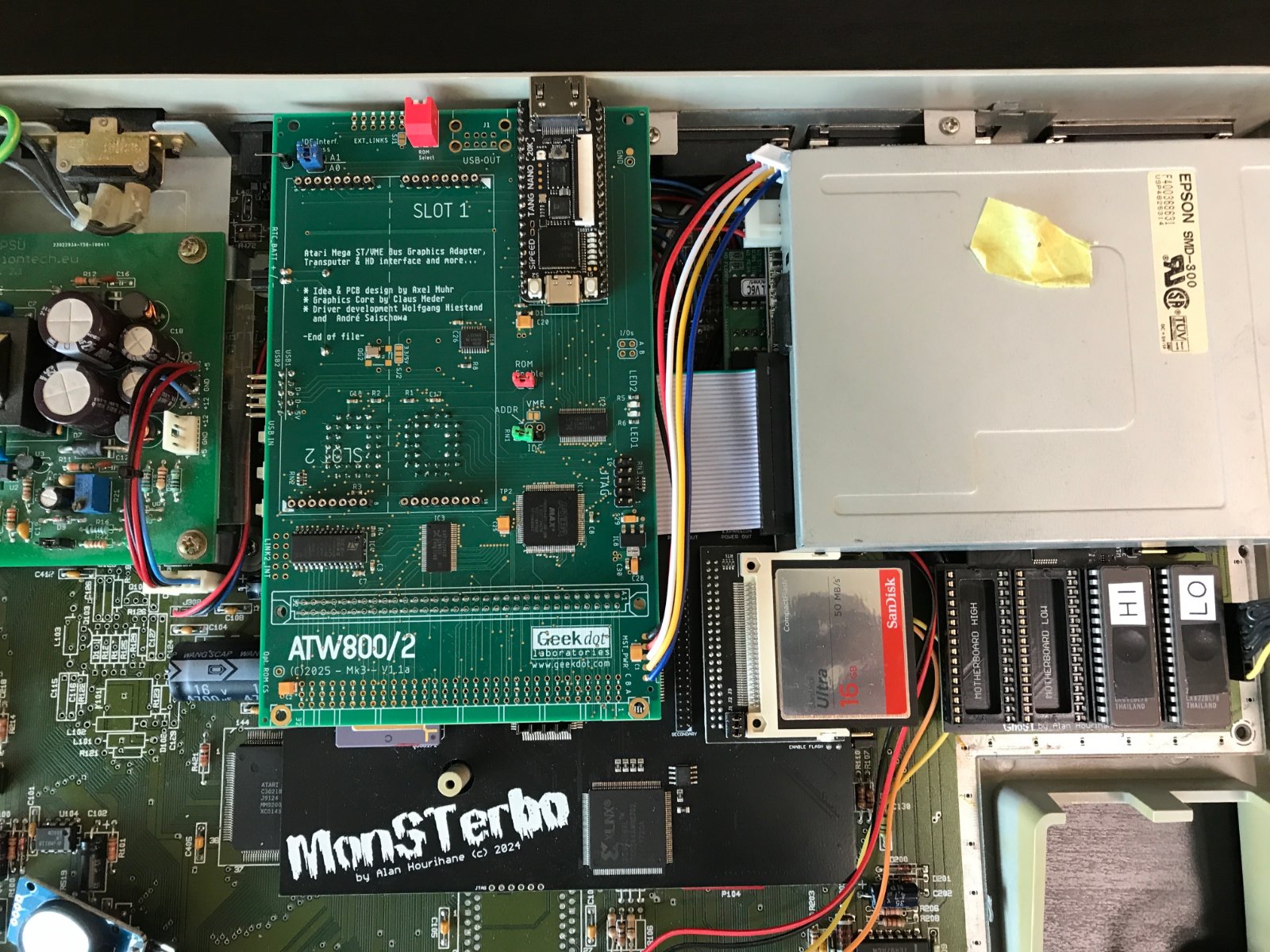

I had to mod the ATW800/2 a bit in order to fit it in my machine, so I removed the USB port and shortened the DIN connector (it goes without saying that I tested the ATW800 in the STE before modifying it !).
It now fits perfectly, but I need to cut the case to have access to the HDMI connector or try to relocate it with a HDMI flex cable...

Ok, so a flex HDMI cable won't be possible as there is no clearance between the HDMI connector and the STE case.
Hate that, but I have to mod my case...
