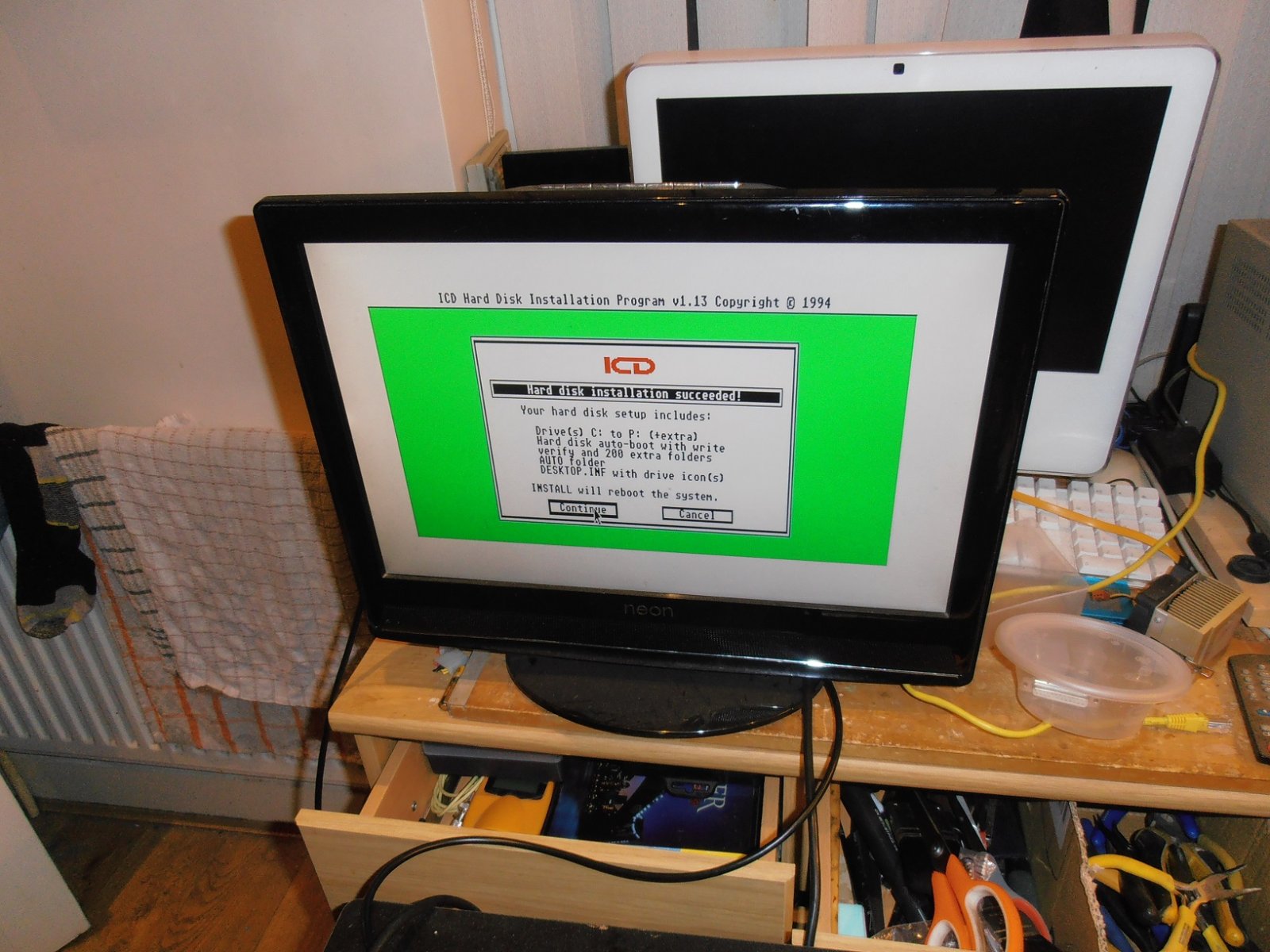

It didn't work until after some more digging I discovered that there is an unpopulated jumper on the ACSI2STM pcb labeled strict ..
I retrofitted that jumper and linked it.
Now ICDpro worked..but is legacy and running it divided up my 1gb SD card into drives from C: to P:
Only 5 of these are accessible to the ACSI2STM ....via GemDesktop...and non of them via PC.
My assumption for now is that the free legacy option is a throwback to the days when a physical drive would probably be in the region of 40 mb in size.
I clearly have much yet to learn about this process.

Whilst HDDriver is the more expensive option, it is the most flexible IMHO. It is also still under development and is updated regularly.
Using the older drivers like ICD won't allow you to simply put the SD card into a PC and copy software directly to it, the partitions are just not visible on a PC. ICD is a good driver but very old.
