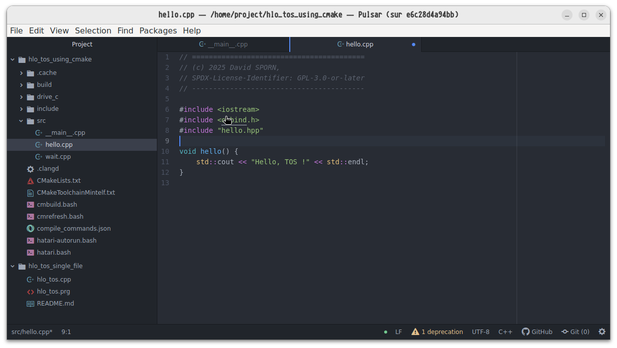

Today, I wanted to refine the navigation inside the code, more specifically, check that it is possible to Control+Click on a standard header and then the IDE opens it.
TL/DR : I got it working, at least for header directly included by a source file in the project. Here a snapshot showing that "<osbind.h>" is clickable, and then the IDE opened the file. However, in that file, <mint/osbind.h> is not clickable. Most likely because the "hello.cpp" from the project has an entry inside the compile_commands.json generated by cmake, but not system header files. By the way, directly including "<mint/osbind.h>" allows to navigate to that file.
Capture d’écran du 2025-11-18 16-46-19.png (105.99 KiB) Viewed 919 times
Capture d’écran du 2025-11-18 16-48-57.png (139.1 KiB) Viewed 919 times
So the next step is trying to have navigability of system header files, if it is possible at all.
How I got the result : I had to add a ".clangd" configuration file for clangd, in order to add the system include pathes. This forces those pathes BEFORE other system pathes that are automatically included (e.g. without that, clicking on "<iostream>" shows the header file of the host linux, instead of the header files for atari cross compiler)

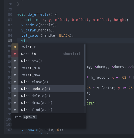

Capture d’écran du 2025-11-19 12-15-54.png (69.85 KiB) Viewed 888 times
Now about writing GEM/VDI application, I found the complete "C-Manship" tutorial, and I ported the program that illustrate chapter 11. The port consisted in using modern c++ syntax instead of K&R, replacing "int" by "short int" (was to lazy to do it, but "short" should suffice), and the VDI call "v_show_c" needs a second argument nowadays. And also add the gem library to be able to build the program.
