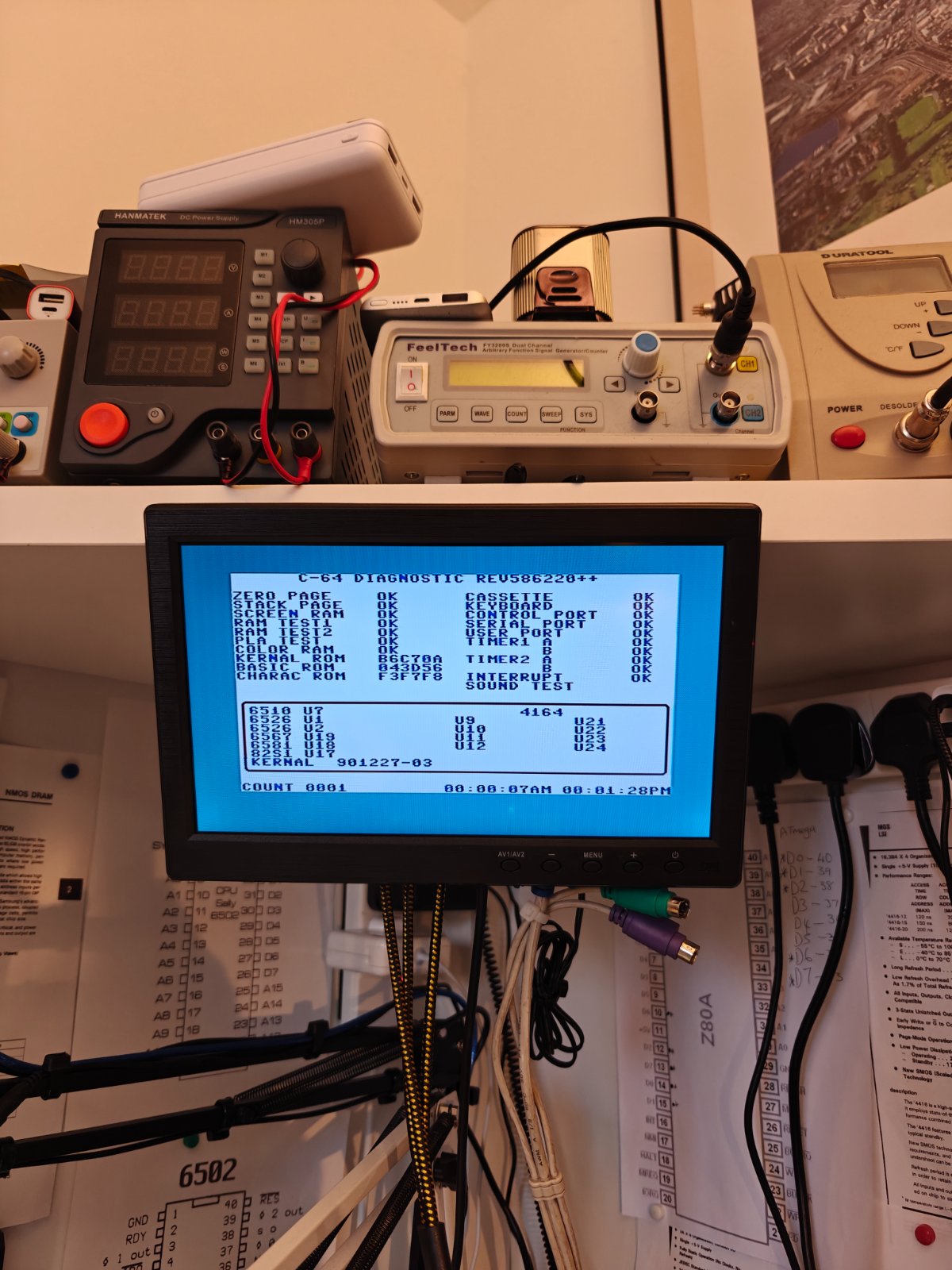

So, after sorting out a bunch of parts for my Cosmac Elf II, I decided to hop onto the 3 C64's from the box.
Machine 1 is a breadbin C64 mainboard, and was rather unhappy. After hooking it up to the diag harness and running the diags cart:
It became obvious it was having 6526 issues. One timer was counting, the other not, plus a number of items were showing bad:
It was shouting bad PIA/CIA so I replaced U2 with an 8520 (An Amiga part but functionally identical) but still had issues, so popped in another 8520 and we are off to the races, the machine works fine now and aside from the 6526 diag test failing (Probably because it's 8520's now), everything seems to work fine.
I was aided greatly by the fact that the mainboard had all the major IC's socketed.
I did some testing with a keyboard attached and my Kung Fu Flash and all seems to be running just great.
Machines 2 & 3 both worked just fine and passed all tests out of the box.
So @mrbombermillzy it seems that you have 3 good C64's with me now :)

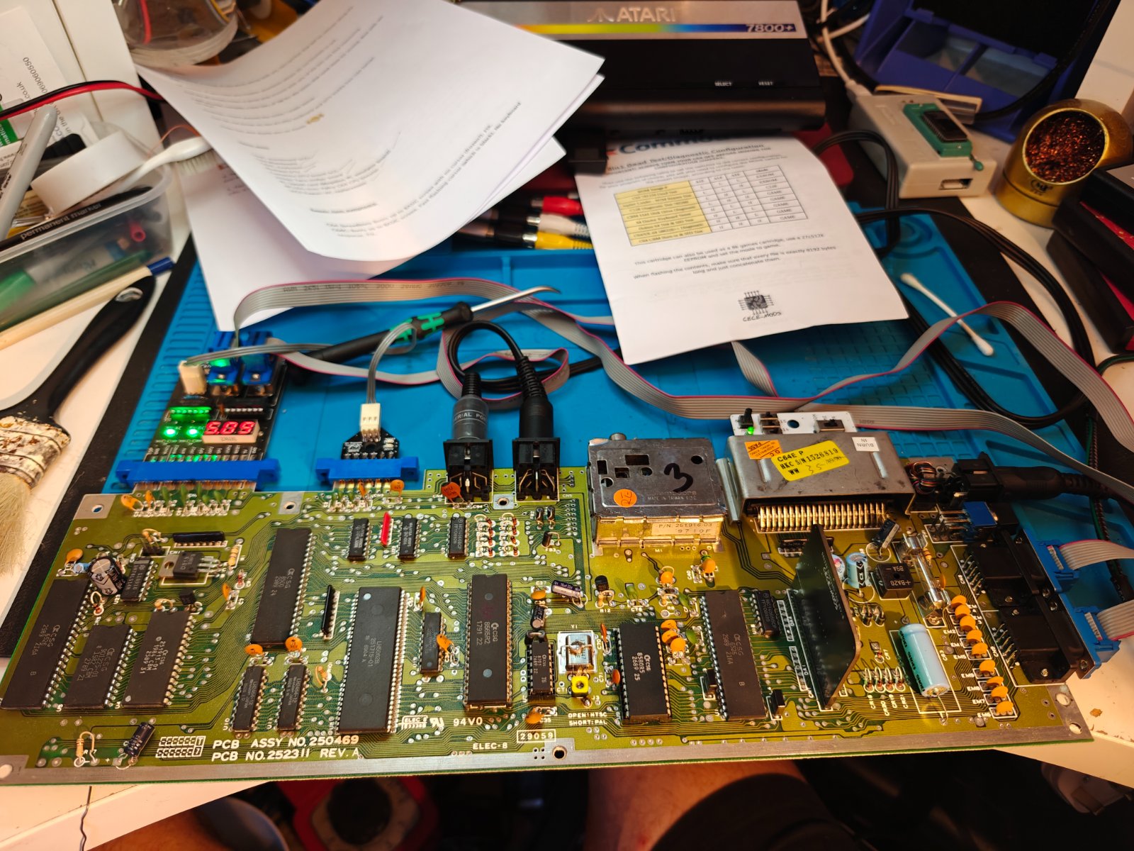

So here is the BB with all the bits fitted:
What I would say is that I think you'll need to do some tinkering with the MCL64, it seems pretty crashy so may need some updates. It won't even run my diag carts properly, though I have found that after turning acceleration off the palette seems to be normal again. Other
Aha!!
I discovered that with acceleration off, the palette is normal C64, with it set to game, it is black and white with a red border, and finally full acceleration is black scree and border with white text.
I guess that is so you know what accelerator mode you're in.
