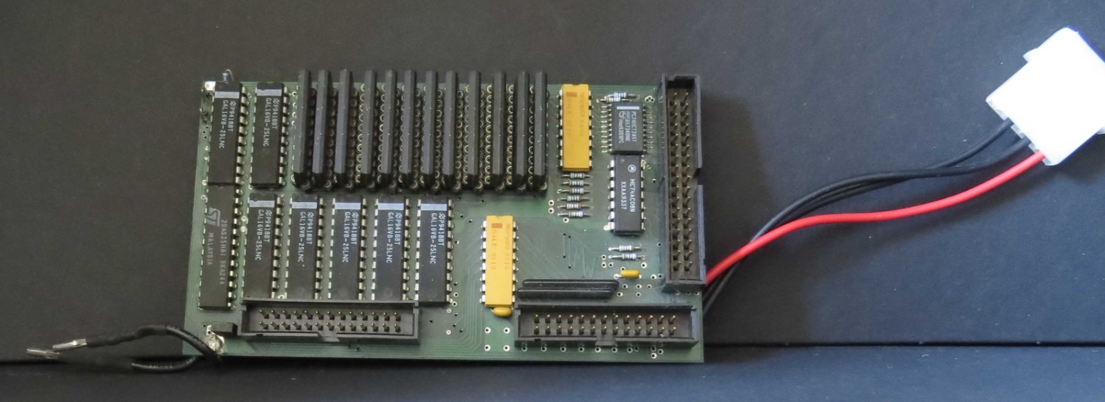

Richter Distributor and DIGISHOP from Vienna or Martin Wevelsiep had 14MB-15MB real ST Ram extensions back in these days ...
The Wevelsiep extension works in such a way that it manages 8 individual 2MB RAM banks for the standard Atari ST MMU.
ST Version ...
Martin Wevelsiep 16MB ST Ram.jpg (344.15 KiB) Viewed 2463 times
MegaSTE Version (10MB max) ...
