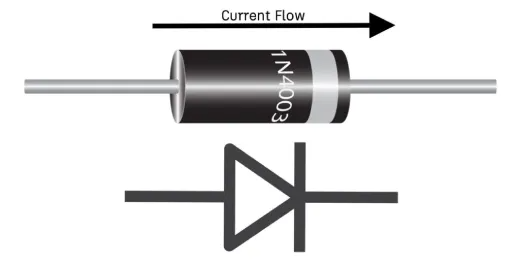

I may want to try to add such a cap or diode, which pins should I connect then in the what direction?exxos wrote: Sun Jun 01, 2025 7:25 pm The IMP chips are known to be "noisy". Maybe the extra SMT caps is causing more spikes on the power rail now the DAC board is applied. But its only a guess. Atari added a diode like a 4148 in series with the IMP chips power rails for such issues. But don't recall it ever being done on a shifter. You could try adding more bulk capacitance, like 1,000uF or more on the shifter power rail. Or try a non-IMP shifter to see if that solves the problem.

5V goes in on the left and the right side, goes to pin 40 of the shifter, you will have to gently bend it outwards from the socket to solder.
