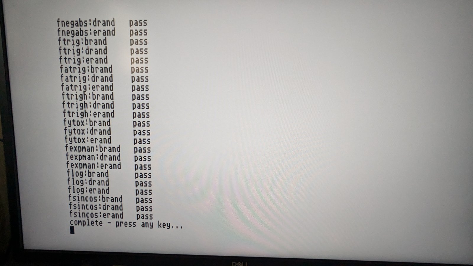

There is a FPU Emulator out here so you can run DML FPU Test with a I/O mapped FPU ...
https://www.atari-forum.com/viewtopic.php?t=40516

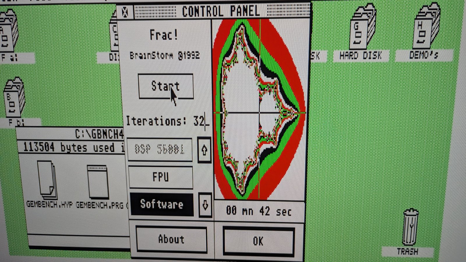

1040 ST/e TOS 2.06: FPU Emu. + DML's FPU TEST + ICD AdSpeed STe 16Mhz + FPU I/O 50Mhz 68882 :D

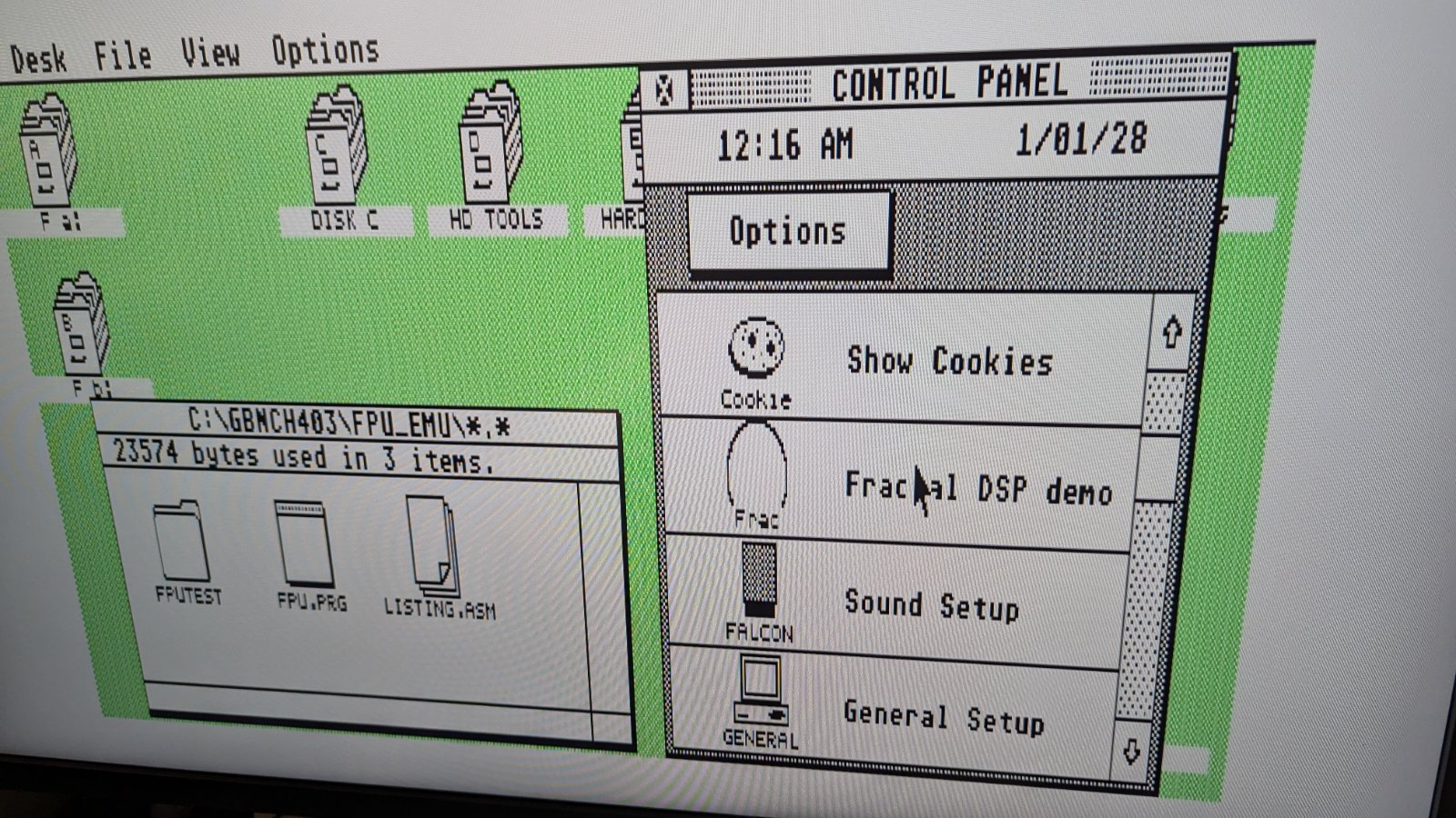

Not sure what this FPU emulator is doing but it seems the CPU is the main speed factor in the calculations.
EDIT: Oh wow doing it in software beats the FPU by a lot :D

nice fractal CPX, where I can find it?

I pulled mine off the Falcon hard drive but try this https://www.atariuptodate.de/en/7997/frac
