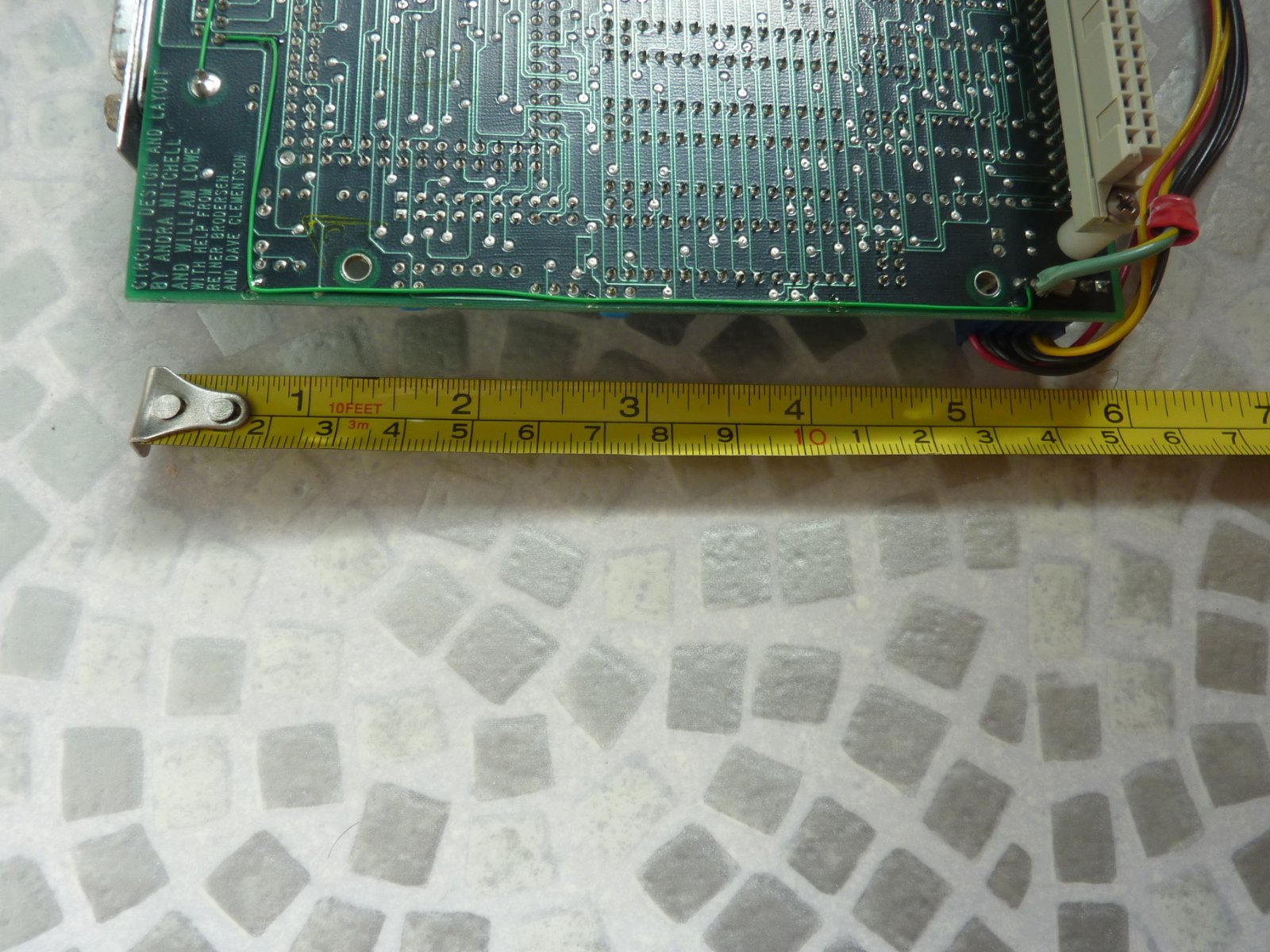

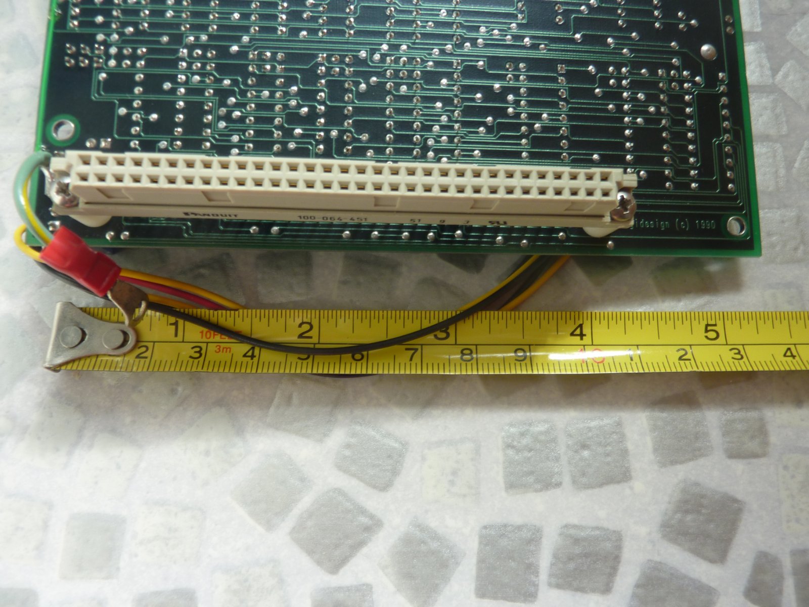

Re: Megabus dimensions
Im happy to oblige:Badwolf wrote: Tue Sep 08, 2026 10:07 am Perhaps @mrbombermillzy, you could measure the sound accelerator card?
When photographing - as the card isnt flat - it skews the perspective distance between card edge and measurement notch, so its better to give actual dimensions here.
The card measures 140mm from backplate to end of card.
135mm width.
The backplane thickness or height is 28mm.
Let me know if theres anything Ive missed off the photos and I'll measure it up for you.
Lovely, thanks!mrbombermillzy wrote: Tue Sep 08, 2026 2:59 pm Let me know if theres anything Ive missed off the photos and I'll measure it up for you.![]()
This is all just a first approximation for now for a prototype so with any luck that'll be plenty.
