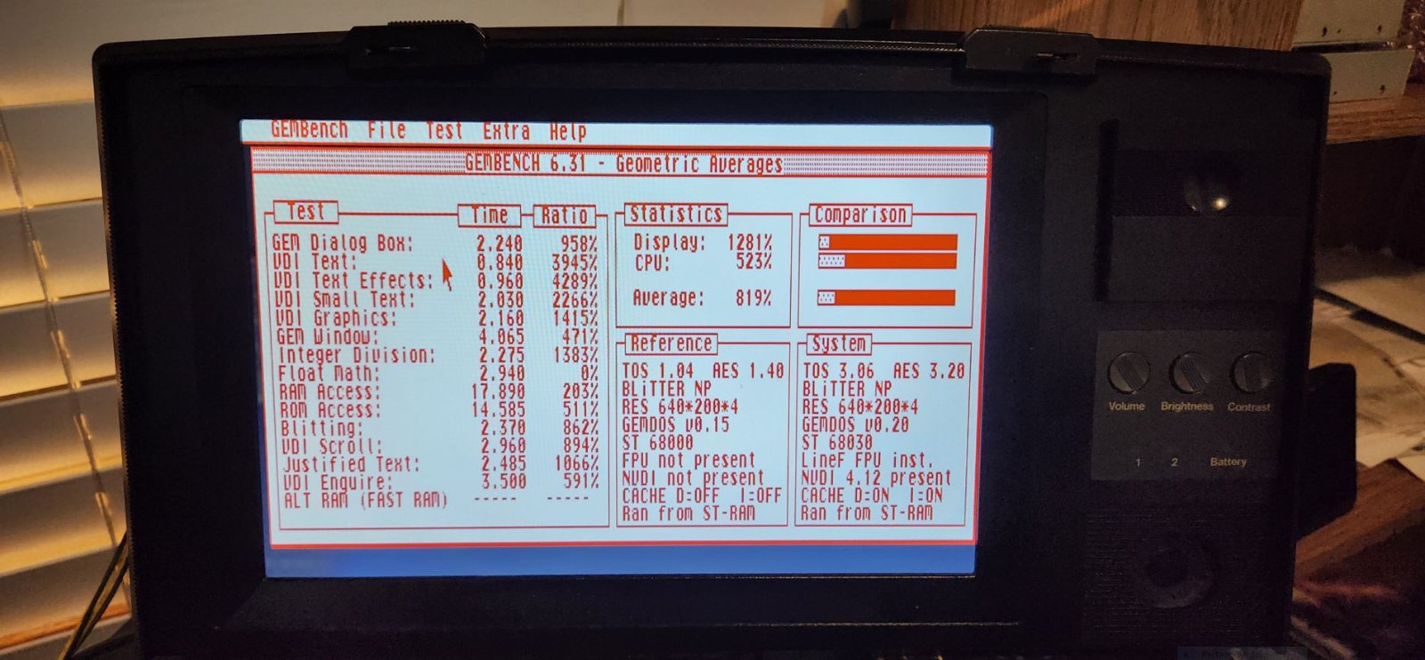

Hmm, I've got some puzzling behavior here (I know, it's a recurring theme with me). :roll:
There is something odd going on with the Pak board and the STorm-ST board. It's to do with
Gembench results. Look at these pictures and see what I mean.
The first is with the Pak board, NO STorm-ST, NO NVDI:
The second is with the Pak board, the STorm-ST, NO NVDI:
The third is with the Pak board, NO STorm-ST, NVDI:
The fourth one is with the Pak board, STorm-ST, NVDI
It appears that the STorm-ST board being on results in a lower CPU score and
if NVDI is present, the CPU goes even lower?
Anyone else seen anything like this or have any idea what it's doing?

First picture is the STacy, with the Pak, with the STorm-ST board active, and both GB caches turned off:
STacy-Pak-STorm_ST-NO Caches.JPG (187.17 KiB) Viewed 970 times

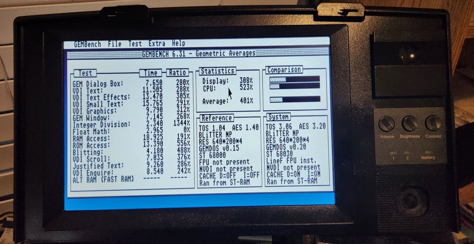

And the second picture is the STacy, with the Pak, with the STorm-ST INactive, and both GB caches turned off:
STacy-Pak-NO STorm_ST-NO Caches.JPG (184.82 KiB) Viewed 970 times

It looks like the aggregate cpu score goes down when your (slower) alt-ram is enabled.
Not sure if that makes sense or not, maybe it does.
All other things being equal, if you have 200% ram speed from st-ram (assuming due to pak cache?) but only ~117% when using non-cached altram on the storm board then perhaps it makes sense that the aggregate overall score ends up somewhere in between.
Chances are some programs will run from alt-ram, and thus a bit slower.
The individual test results look sane and roughly equal for storm vs no-storm, it’s mostly that alt-ram is taken into consideration on the overall average when storm is enabled.
NVDI probably loads into altram when you have storm enabled and may or may not become a small bit slower than your (probably Pak L2 boosted) ST-RAM.

agranlund wrote: Tue Jul 23, 2024 8:57 pm It looks like the aggregate cpu score goes down when your (slower) alt-ram is enabled.
Concur. The headline CPU figure has a statistical dilemma on its hands: how to deal with a ratio that simply wasn't there in the first place.
The interesting scores for me are the display ones. I particularly like VDI Enquire as an indicator of grunt, personally.
With NVDI, as Anders suggests, it probably loads into AltRAM and so relative speeds go down, so that expected.
But they appear *faster* with the Storm-ST board (without NVDI) than without despite GB6 running from ST-RAM. What gives there?
I believe blocks of Amiga RAM have the concept of a priority. I don't think we do in the ST world. AltRAM is AltRAM and if a program can run from it, it generally will. Even if it's slower than ST-RAM.
