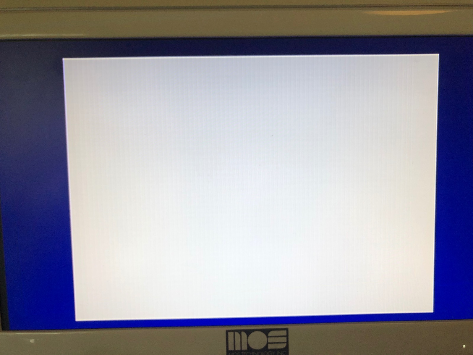

My Atari 1040stf when cold runs normal and when hot just shows white screen when switched on and no seek on floppy. Diagnostics comes up with either E9 error or red white blue white screen background. I have cleaned the contacts with ISO. Before I open the computer and re-seat the chips wanted to get your guidance what may my be the issue here. When cold the diagnostics shows zero problems. Attached some pics. Thanks in advance.
Atari 1040stf tos 1.0. E9 error when running diagnostics cart

I'd suggest that you connect to a serial terminal such as Teraterm on a PC and see what the output is before going further.

@rubber_jonnie Hi There, thank you for your advice. Appreciated. Sorry, I am a rookie and at home have only access to a Mac.
Any other ideas please?

You'll need a USB serial dongle for a start. Then install "SerialTools" from the app store. You should then be able to set up a terminal emulator and the serial parameters to connect (with the correct cable).
