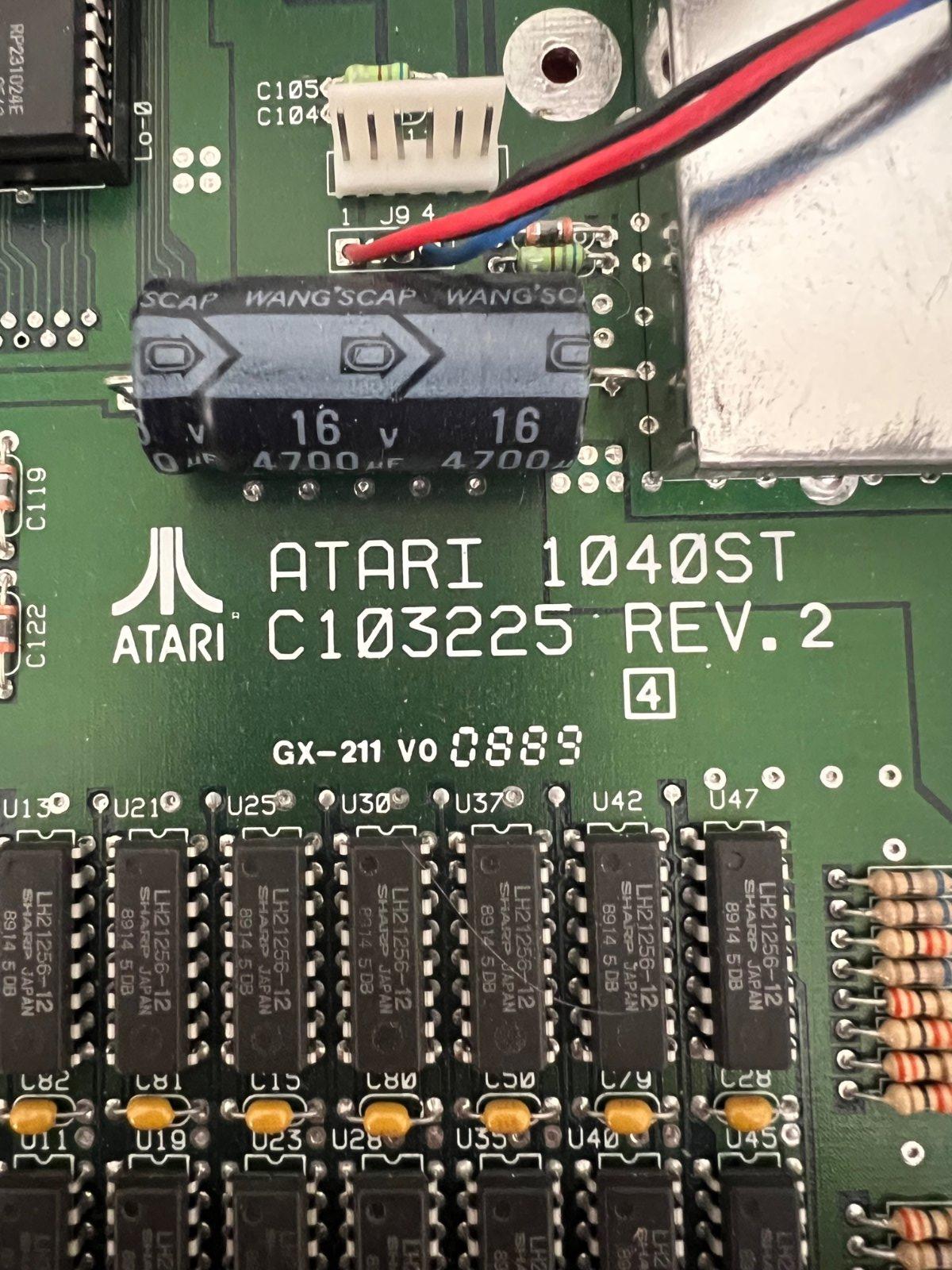

I already recapped the PSU. Also, upgraded the TOS ROMs to Rainbow TOS. I had to install 4 additional TOS ROM sockets, since the Rainbow TOS ROM chips I had was the 6 TOS ROM version. I also reflowed the solder on the mouse/joystick DB-9 ports on the bottom of the keyboard. I will reseat the chips that can be removed and reseated. I have not located the caps for the reset circuit. I have not found schematics for my specific 1040 STFM motherboard model. Photos of my STFM are below.
After the upgrades I performed, I used the ST for a bit. I ran SysInfo to verify the upgrade TOS was properly recognized. Ran a couple of other programs just to be certain all was ok. Since I wanted to test the keyboard to ensure all of the key worked properly and did not have a keyboard test program, I plugged in the Exxos Diagnostic Cartridge. I was unaware I had arranged the jumpers on the Exxos Cartridge at that time. So, I started up the STFM and the restart/reset cycle started immediately. It continued to restart/reset until it displayed bombs (4 as I recall) So, I turned of the ST, removed the cartridge, the turned on the ST with a SysInfo floppy disk. It looked like the ST was going to start up, as I saw the desktop and the SysInfo window from the floppy disk pop up, then the screen blinked and reset. The reset continued without stopping until I turned of the ST. However, there were zero bombs. I shut down and restarted a few more times, with same result, continuous resetting until I powered off the ST.
I will disassemble the STFM again and check all of the cartridge slot pins to make sure the solder connections are solid as well as check to make sure none of the cartridge socket pins are bent.
