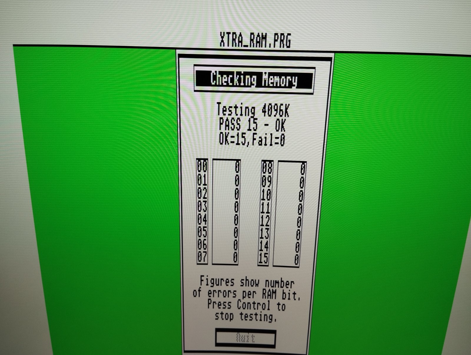

STFM 4MB RAM EXPANSION SUCCESS
Upgrade your RAM from ST to Falcon.
gigi92
Posts: 32
Joined: Tue May 14, 2024 11:25 am
Post by gigi92 »
Just to say thank you, you are the gods. Too happy to have an STF with 4MB of RAM. It's hard (dé solder) work but it's worth it !
