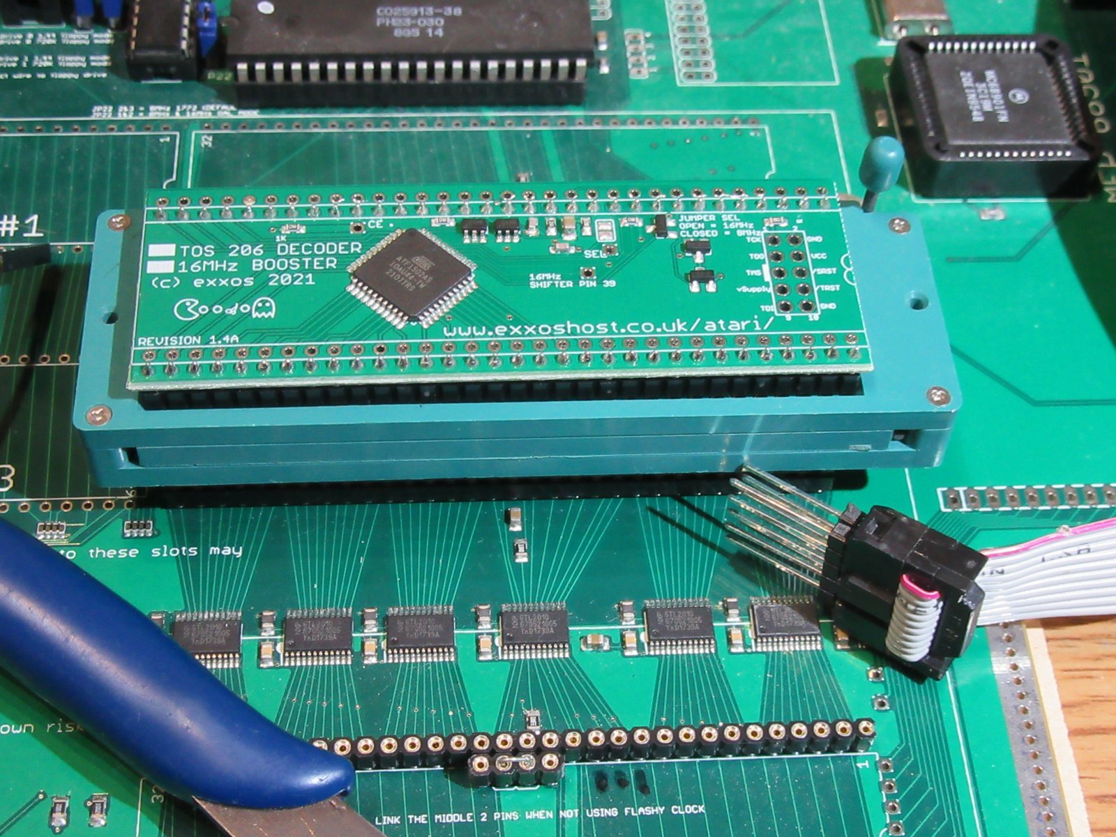

Additionally the ZIF sockets I have used don't generally align to existing sockets anyway. For example..
That 68K ZIF socket , IIRC, was wider than the actual 68K socket. So if I remember rightly I soldered header pins onto the ZIF to insert into the turned pin socket on the MB.
Having round pin sockets and soldering round header pins to the ZIF socket is likely the "best" "bad" solution. The same can still be done with a wiper socket, but generally round header pins don't contact so well with the wiper sockets.
Alternatively, jamming the ZIF socket into a wiper socket is quick and simple (assuming the ZIF isn't to wide for the socket), also assuming you never want to remove the ZIF socket again. Otherwise the socket will have to be changed.

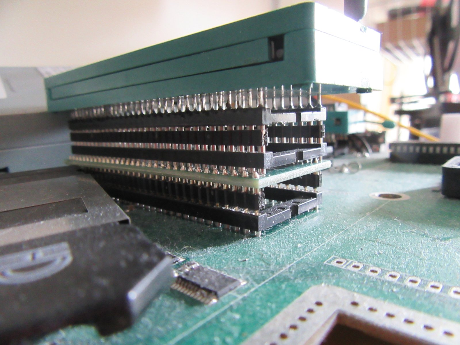

Personally when I needed to do this I made an adapter using proto board and machined pin headers.
The machined pin headers fit into wiper type sockets well enough to make contact but generally don't damage the socket.
The larger pins of the Zif sockets can be too big and/or not long enough for the wiper sockets and either don't fit or cause damage.
