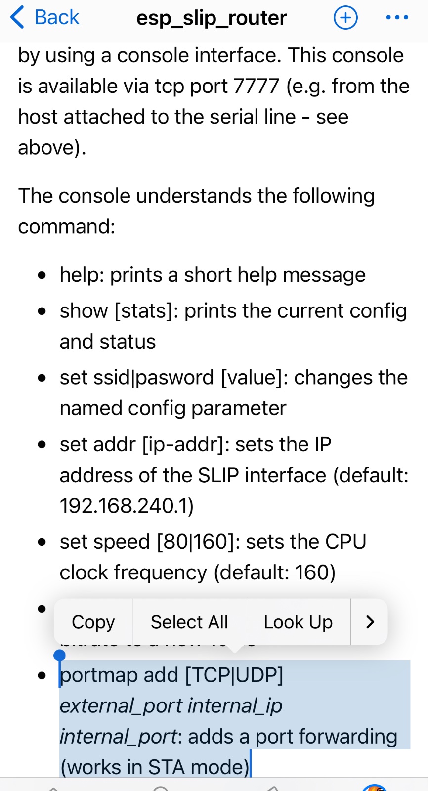

Hey guys,
I've setup an ESP-01 module and it connects fine to the internet via MiamiDX, I wanted to setup the Amiga with a FTP Server for small file transfers from my PC. I think it needs port forwarding setup on Port 21, does anyone know the correct rule command for portmap? Last time I had a go, I managed to corrupt the ESP-01 somehow (or created a bad port map), I then had to erase and reflash :D
Thanks!

Thanks for the reply, yes, I know the syntax. Does internal IP relate to 192.168.240.2 or the IP assigned to by my router?
Posts: 7581
Re: ESP-01 Slip device / portmap question
It would be the port connecting to your Amiga as it's routing the port from the public interface and needs to know where to send the packets.

I had the problem of not being able to connect to the ftp server, luckily I found this post. So the correct command to open port 21 for FTP is:
portmap add TCP 21 192.168.240.2 21
Same for other ports; RSH is 514, Telnet is 23.
