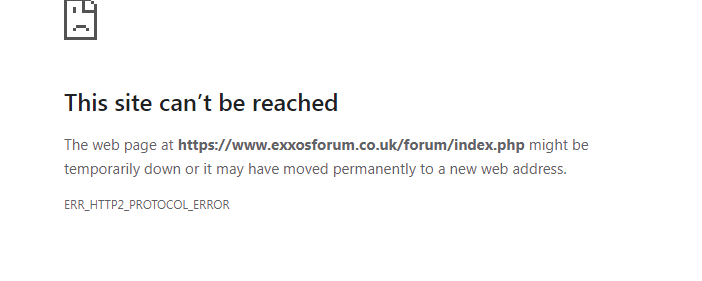

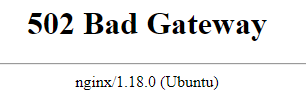

I noticed last night the server was running a little slow but did not think anything of it. However this morning it was returning errors..

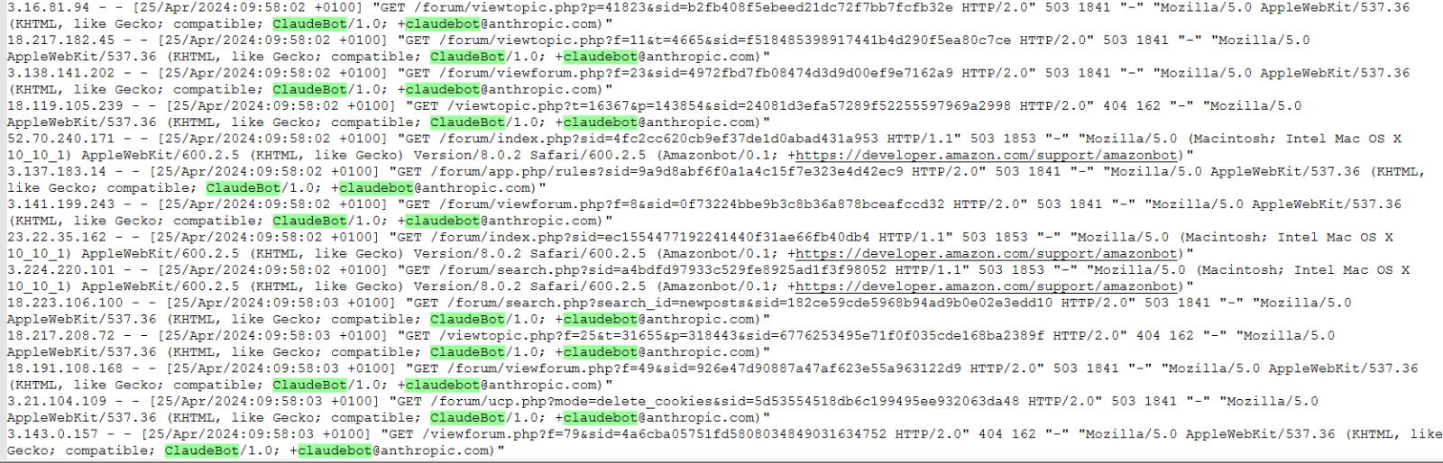

Upon looking on the Nginx log.

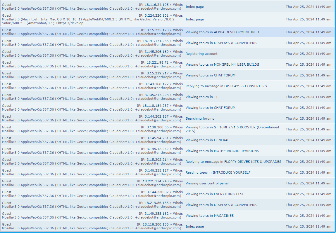

... and later the forum online list..

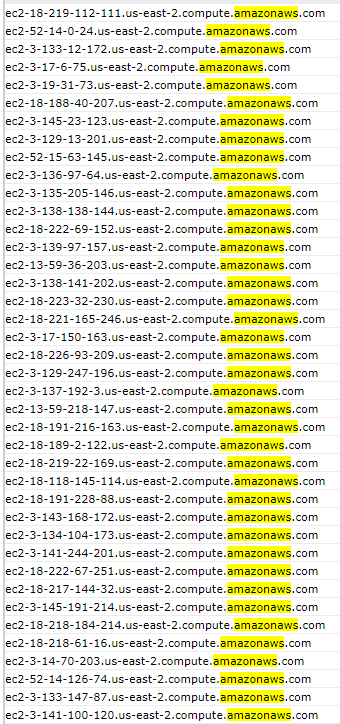

It becomes apparent that ClaudeBot from anthropic.com is opening up 100's of requests per second from various IP ranges. It just simply got to the point where the server 4 CPUs maxed out. It seems our old friend amazonaws.com is providing the bandwidth for it all again.
Blocking individual IP addresses would be a nightmare. I would have to block the entire 3.xxx.xxx.xxx range to stop those attacks. Plus as these attacks keep on happening, it is pointless to try and firewall them any more.

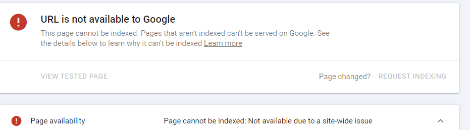

It seems that there is no way to get Nginx to work with a blacklist AND a whitelist.
Unfortunately white whitelisting bots also seems to then cause problems with Google indexes..

3.15.15.56 - - [25/Apr/2024:21:28:58 +0100] "GET /index.php?sid=f83932fc34520562a3f333d83f7d09d1 HTTP/2.0" 444 0 "-" "Mozilla/5.0 AppleWebKit/537.36 (KHTML, like Gecko; compatible; ClaudeBot/1.0; +claudebot@anthropic.com)"

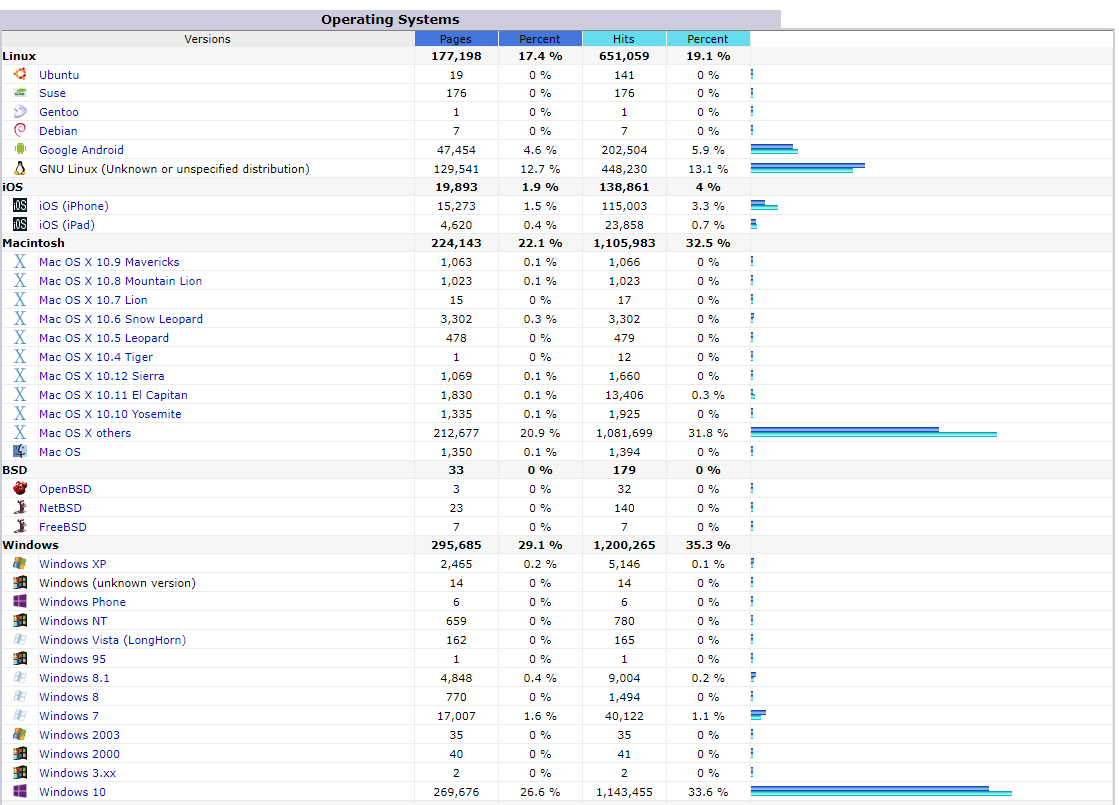

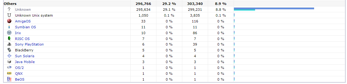

Looking at my stats there was a total of 904 different amazon IP addresses hammering my server all at once. Each IP had about 2,000 hits each. There was no delay in how fast the requests were being made either.
All files on my website had multiple hits.
As a side note, Operating Systems used last month..
