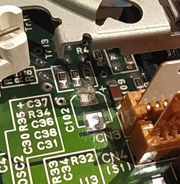

The floppy drive was dead. The original owner bought a new drive belt and tried replacing it but was unsuccessful and 2 SMD capacitors parted way from the disk drive PCB!
We all know each computer has its known faults that materialise after decades, and the Sam's seem to be the SMD caps and drive belt on the Citizen disk drive.
After an initial clean-up things looked ok. The PCB pads are massive compared to Amiga ones
I then used my microscope and scrapped off corrosion. There are 3 resistors near C102 (lower pic) and the right most resistor took the brunt of the leaking capacitor. It had detached off the PCB nearest the cap. Thankfully it was just a 0 Ohm, so I replaced this with a bit of wire and managed to do this without stripping the disk drive down any further.
After a bit of fun trying to get the new drive belt around the pulleys, I had a working disk drive :D
