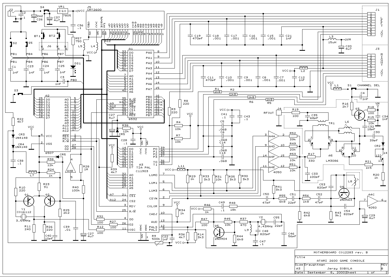

Mostly I was just looking at circuit diagram itself... Seems difficult to work out as a seems to be multiple revisions which all look very similar, but the part numbers a very much different.. Not hundred percent sure what all the differences all of the diagrams or even correct...
Basically the TIA outputs all the necessary video signals, then basically wire them all in parallel to generate the signal .
If you look there is a buffer 4050 there with the Vista ladder where at that point should basically be the composite signal. However it is possible the resistor values may be too low, which could be why people using a transistor to amplify the signal.. Course there is two ways of looking at it, as you can either add the amplifier, or replace the resistors with lower value ones like 1K,2K,4K kind of thing.
In a lot of mods I think Q4 gets chopped out as well . It gets a little messy with the colour output from the TIA.. That could possibly need slight tweaks as well.. But of course I have not looked into this much yet.. I think there was a sight which basically did what I propose here, but I did not seem to bookmark it :roll: I will try and find it later...

rubber_jonnie wrote: Fri Feb 23, 2018 3:23 pm One thing I don't understand is, if the signal is available there, why remove the modulator?
I think it is to reduce interference on the video signals... As to if it actually helps or not I don't know.. But it makes sense to remove it..
rubber_jonnie wrote: Fri Feb 23, 2018 3:23 pm As for Q4, I'm assuming that's an audio amplifier that feeds into the modulator, so why would you want to remove it?
Same thing I presume, looking at this diagram...
Anything else connected to the line is likely just going to cause problems...
I would probably go with that diagram myself... But I would also be tempted to replace the 4050 with probably a LS chip which will have faster switching and a little bit more drive current.. A quick look the pinout seem to be somewhat different so it wouldn't be a straight swap :(
