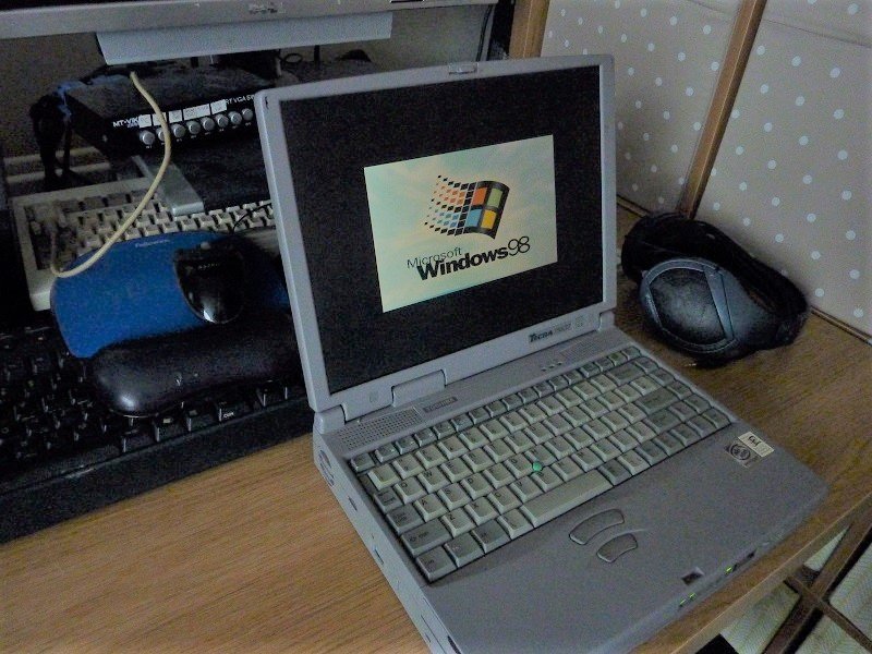

So, (in the wrong order as is usual around these parts) the PSU arrived and I spent some time trying to get a good solid OS install onto the Tecra.
To be fair, i was quite Impressed that a machine circa 1997 was actually fully working; the CD-ROM drive was good, the screen had a good brightness level and the little 5.1Gb drive seemed to be working. Dammit, even the battery held a bit of charge when unplugged (I didn't really test how long it lasted, but still, I'm very impressed).
After wasting some time on a pre-existing W98 install, I decided the most versatile and best fit option was really to do a clean install of W98SE.
This machine has a Pentium 233MMX and 96Mb RAM, so that should be ample for the OS.
Here we go:
After much churning and whirring of drives, some settings being clicked and timezones being set, we finally arrived here:
Now the last real hurdle was to have a look at the device manager and see how many yellow exclamations there were. The screen was small, so I guessed we were still on the basic VGA 640x480x16 colour compatibility driver.
Speaking of which, the hunt for drivers had come up empty. I didn't want to download who knows what from who knows where type driver download sites and the Toshiba support pages (now handled by Dynabook) seemed to have recently removed most of the drivers for this machine.
Even trying Toshiba.co.uk on the wayback machine didn't really help. Their old site was, well, weird and unhelpful to say the least.
Time to rip the bandaid off then:
Heh! Well that doesn't look too shabby at all! :) I guess being a very expensive late W95 era machine made sure most of the drivers ended up being included with the later windows version (98/Se) as standard.
The only thing missing from that list is the video capture drivers, which I can live without. I can probably cope with basic drivers for the rest. Great!
Next up, I get to dig out the VR hardware, or perhaps test a C64? Who knows? :lol:
