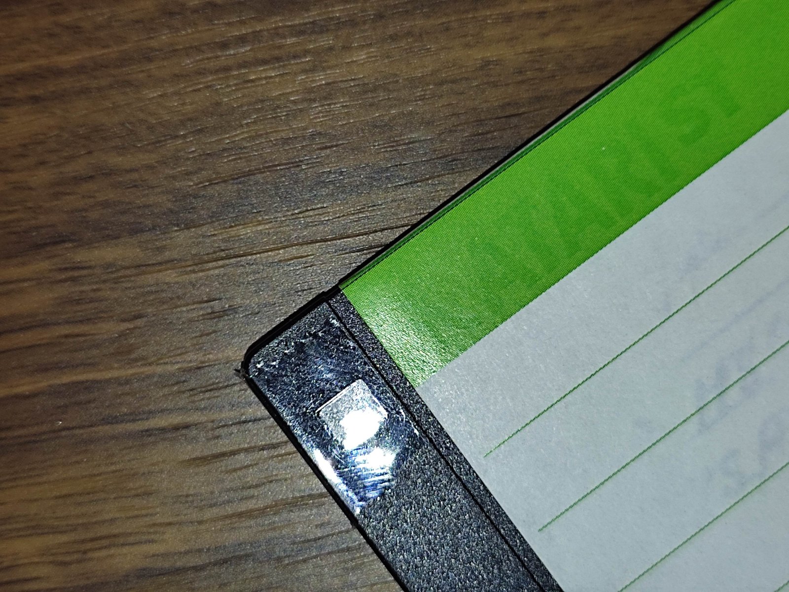

Posts: 7689
Re: Floppy drive write error - using pc 1.44 modified
Just a quick suggestion. Tape over the HD detect hole. On one of my drives it wouldn't format to 720K without doing that.
Telsud
Posts: 5
Joined: Sun Feb 27, 2022 8:39 am
Post by Telsud »
Ok thank you Exxos, I will do some experiments.
Do you confirm that the only I must do to convert correctly a drive IS toi change ds1 to ds0?
Thank you too Phil, but already done ;)
