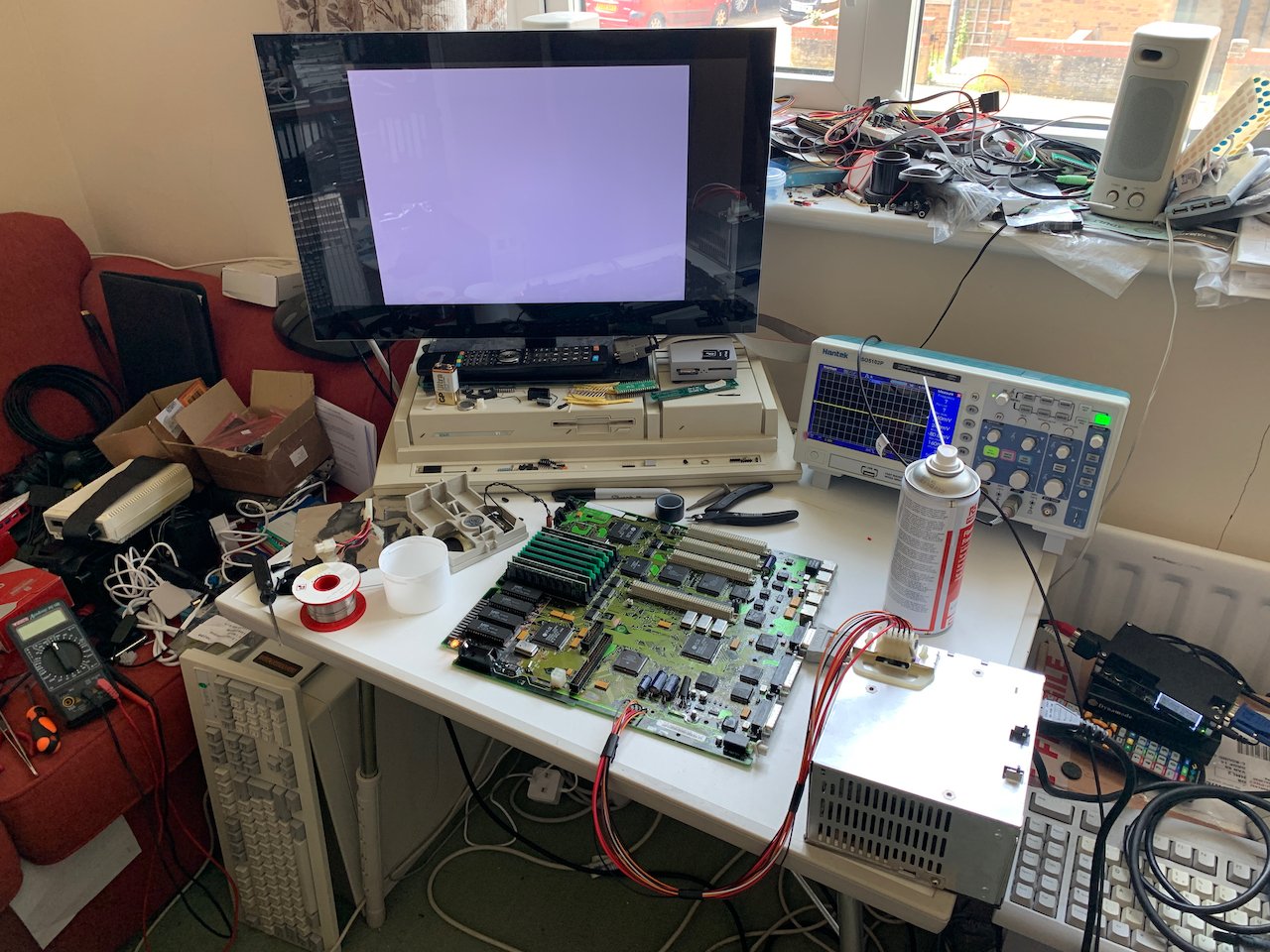

This machine has been through a few hands before it reached me.
It bongs with memory but there's no display. It also doesn't access the floppy or the SCSI (suggesting a VIA problem amongst other things).
As the PSU sits directly on the motherboard and the chips I need to test are, as sod's law states, directly underneath I created a power extension cable this morning. But it doesn't work. The PSU just keeps turning on and then turning off. At first I thought it was a short even though I'd quadruple checked the wiring. However, i think it's the power-on signal is being attenuated to much and I need to shorten the cable, as I made it 2m for flexibility.

Right, I've got video out by setting the VGA adapter to the correct DIP switch settings. (If the IIci's video chip doesn't see the right sort of monitor it turns the video circuit off!.)
From the looks of things the memory management unit isn't giving the video chip access to RAM, or at least when it does it's not halting the processor. Given that the MPU is where the battery damage was this does seem like it's a likely problem area.

It's the default grey/white screen before the CPU initialises anything. If it chimes then the display goes black.
About 80% of the time it crashes before attempting to fully initialise the display (and then crash) so I'm wondering if there's an address bus issue or some other signal which is not getting through to the CPU. The problem is that everything's surface mount so it's difficult to set up instrumentation.
