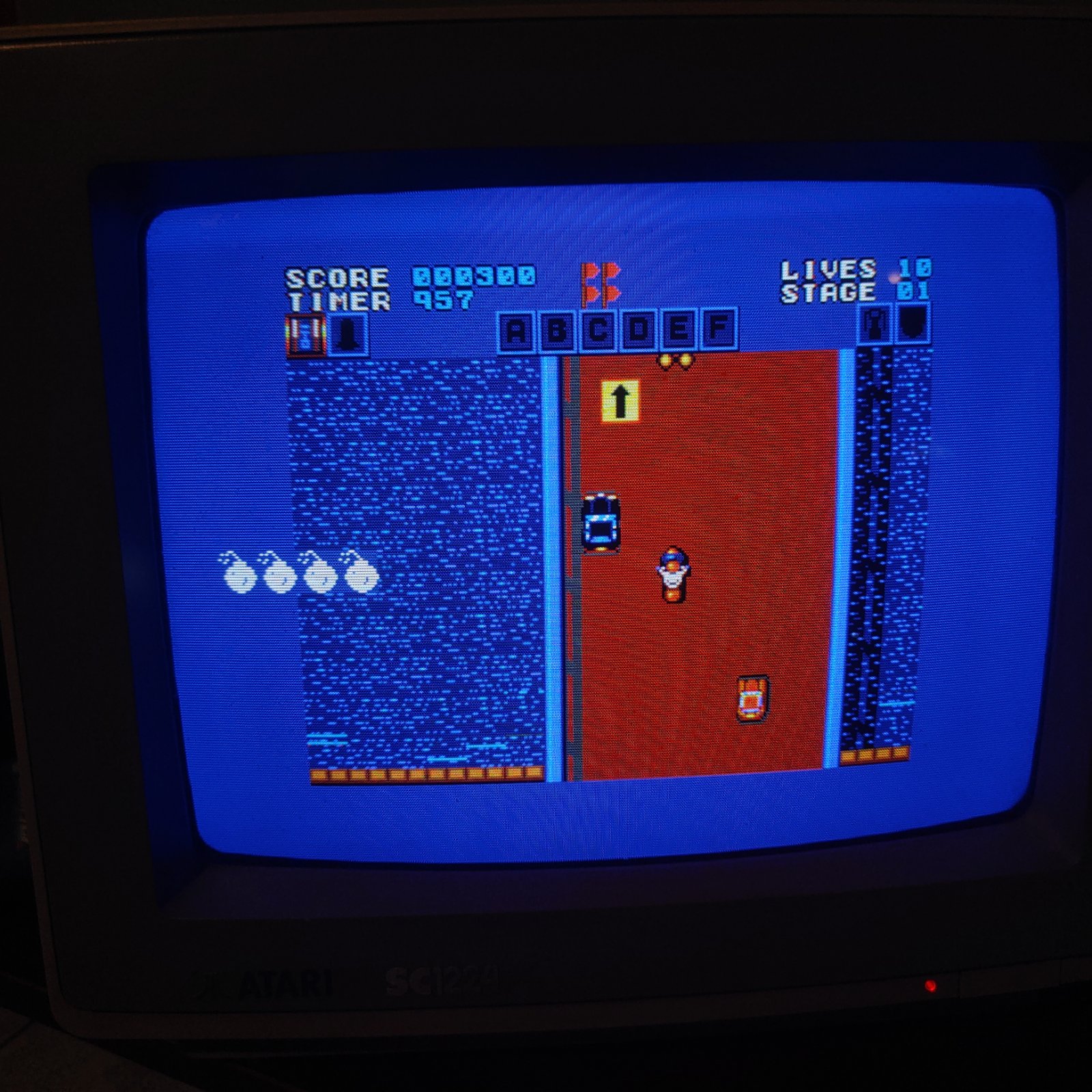

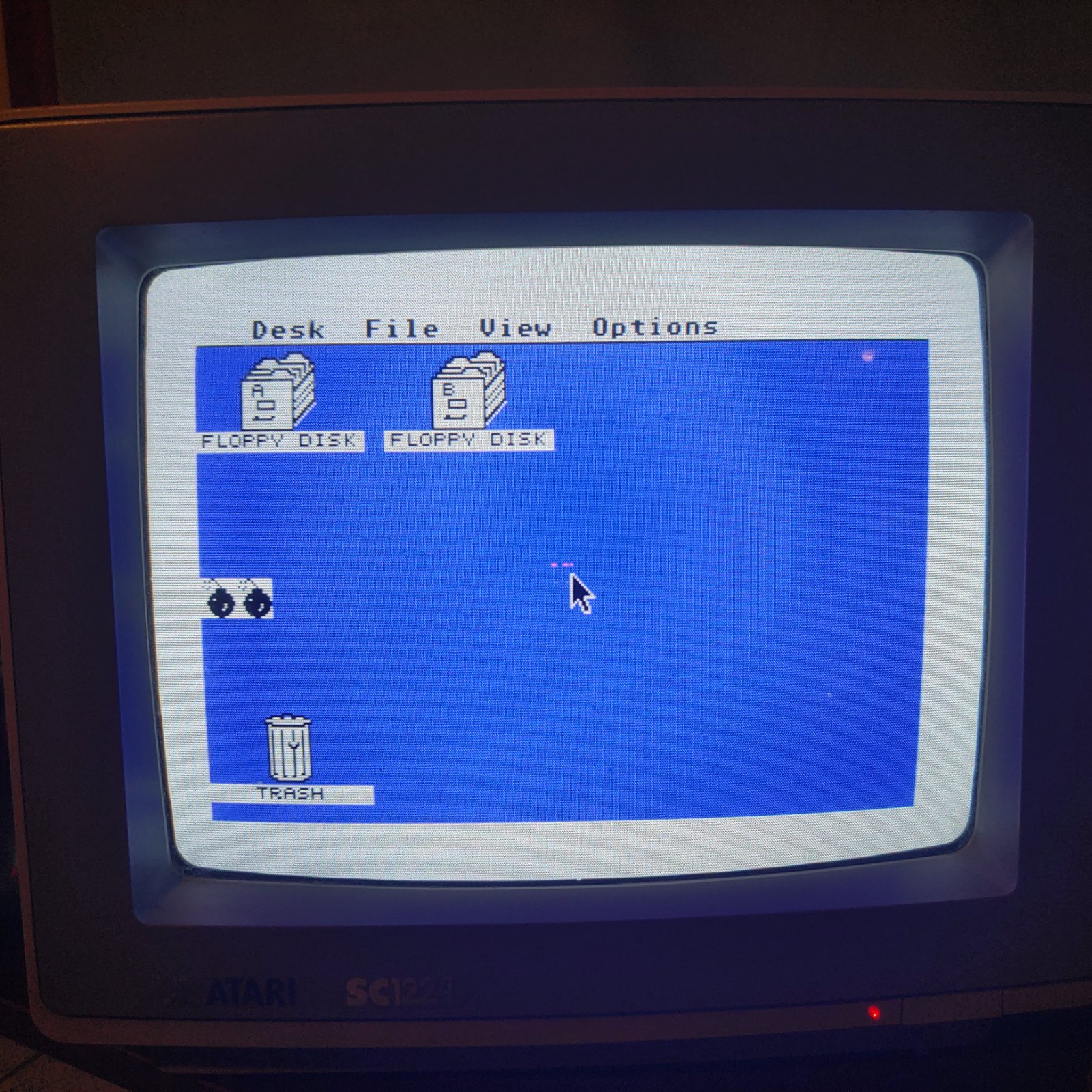

Hey everyone! My poor STe has went from bombs on the screen after running for a few hours to now a white screen and won't attempt to cycle the floppy drive. I'm hoping you all can tell me where to start since I'm a noob to diagnosing Atari STs. This is gonna be a long post so I apologize for all the reading you're about to do.
System info and mods:
Atari 1040 STe NTSC
CA4003290 motherboard
4MB non parity ram
Original floppy drive
ASP34-1 PSU
STE V1 32mhz Booster plug in (2020 release according to what is printed on it)
STE TOS Switcher with the U.K. roms installed, also have the U.S. roms for it as well
PSU recapped with a capacitor kit from Console5
So my STe was fully stock when I first got it a few years ago and fully working. I decided to squeeze some more power out of it and grabbed the 32mhz booster, TOS Switcher and the U.S. and U.K. fast roms. I installed it all and the STe booted and ran fine. Eventually I found that after it was running for about 3 hours it would start crashing and if I let it sit for a bit it would be fine for a while and then it crash again. I swapped the ram out and it made no difference. Checked the voltages on the PSU connector to the motherboard while the STe was running and got 4.9 volts on the 5 volt lines, the grounds were good and 11.3 volts on the 12 volt line. Decided to grab a PSU capacitor kit from Console5 since it couldn't hurt and easy enough to do. Still no difference and voltages were about the same. Notice that the solder joints for the keyboard broke and causing the mouse, keyboard and controller not to work properly. Resoldered that and the keyboard, mouse and controller started working again but now starting freezing when it got to the desktop. After restarting a few times it made a hum from the monitor speaker during the ram check, I shut it off and turned it on and now it just shows a white screen. I've tried reseating all the chips and swapped roms and no change. I added pics of the monitor of the bomb error screens I got as well. So now I'm stuck and looking for help on what to do next and thank you for any help you all can give!
