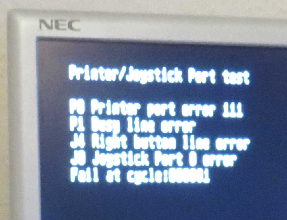

... had the same problem with an Atari Mega ST and on the sound chip was missing two data signals. So see the schematics and check this ...

I'd agree with @frank.lukas , it's definitely worth a look at the sound chip. Pins 19, 20 & 21 are involved in FDD selection.

... D10 and D11 were missing on the PSG coming from the DMA. There are errors with the test cart on joystick and PSG ...

I had no Icons on the Desktop
1. Replace PSG with not change the fault
2. Connect the test cart with the testboard and couldn't do anything with the error message
3. Read the service Manual, see picture ...
4. check all 40 connections on the PSG and found D10 and D11 had no connection to the PSG
5. Fix D10 and D11 reboot the machine and all was fine with the floppy and the icons on the Desktop ...
