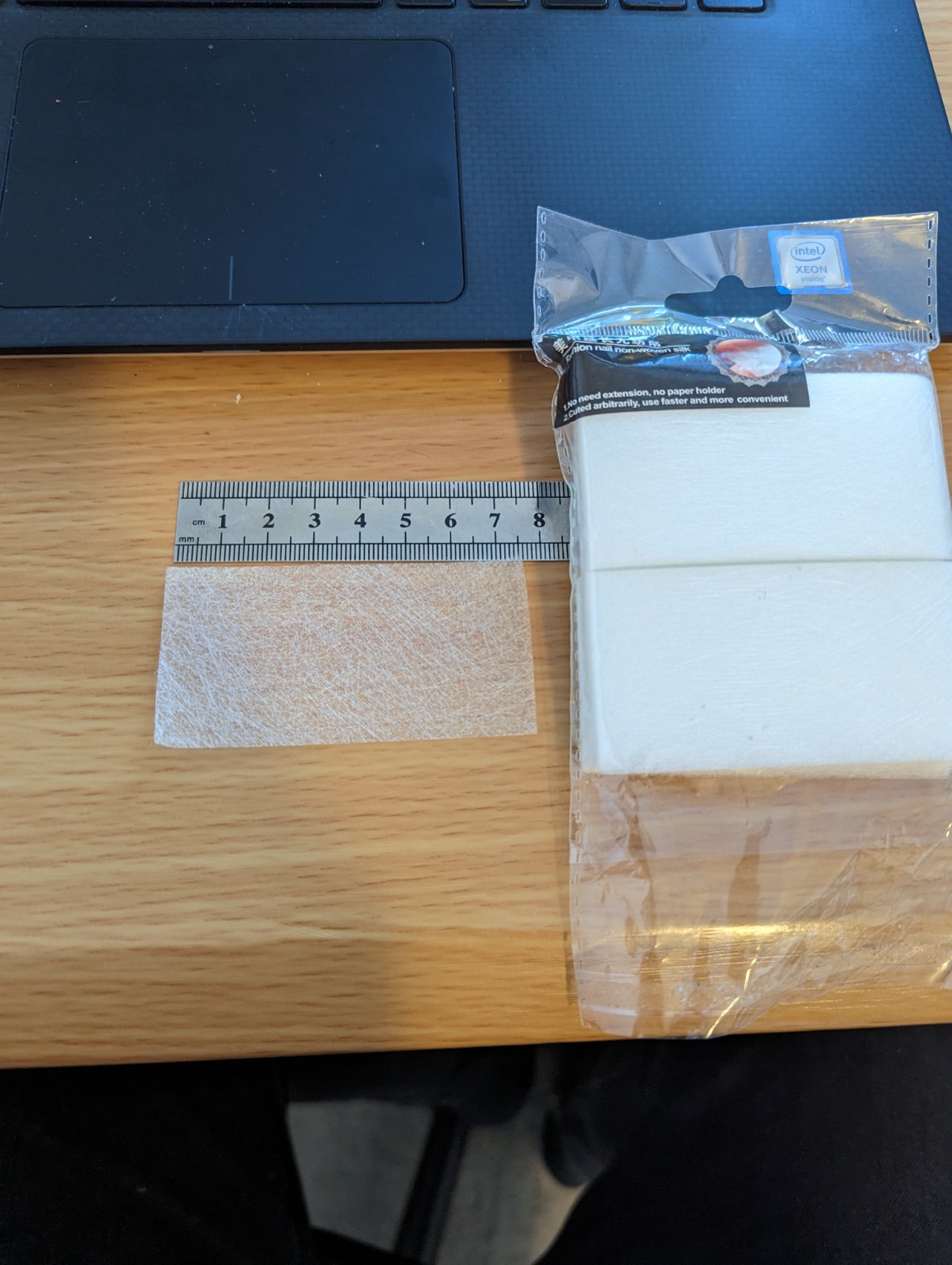

- Posts: 15488
Re: Plastic case repair
BTW, these are the fibreglass patches I use:
You can cut them up into small pieces very easily and they add some integrity behind cracks. They're used in nail bars usually
