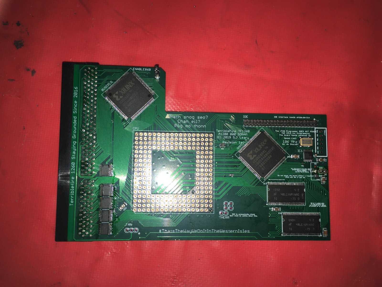

I've been building a few TF1260 boards to sell with some rev 6 CPUs. In fact they were factory built and I just needed to solder on the cpu socket, ide header and connection socket.
I have a couple that I've not been able to diagnose in several hours (just replacing CPLDs + other chips, checking joints under microscope).
Is anyone interested in both for a project to look into properly?
Two boards:
board a) Does not boot at all, RAM CPLD gets hot. I replaced both CPLDs and ram on this board, I also repaired some capacitors & one broken trace.
board b) Boots up fine, but no ram seen. I replaced ALL chips on this board.
On both boards the CPLDs appear on JTAG and program/verify ok.
Looking for 40CHF each (or 70CHF total for both) + 20CHF worldwide shipping. This includes both boards and I can also include 3 spare desoldered CPLDs, ram chips and bus drivers (on request).
I can also include an 68LC060 CPU (or two) at an extra 40 CHF each (special price for with these boards).

OK here we are:
Let me know if you want any close ups.
Spare parts (all desoldered, untested):
Board 1 (boots but no fast ram):
Board 2 (does not boot, hot cpld - even after replacing both of them):
Dead boards (both with broken traces, but have some spart parts on):

I managed to fix the board showing 0 ram, so that one is no longer for sale :shock:

The last one still remains. I think I've changed everything on it several times by now :lol:
Anyway the latest is that I fitted two 'brand new' (from aliexpress) CPLDs just in case there were issues with the various other ones I've fitted. Then I put it through the ultrasonic in case of any dirt I couldn't see messing things up, so its nice and clean.
Still no dice from it though, it just gives me a black screen.
Anyway its still available for one more week and, if no takers, I'll just take the useful parts off it and consign the board to the e-waste.
