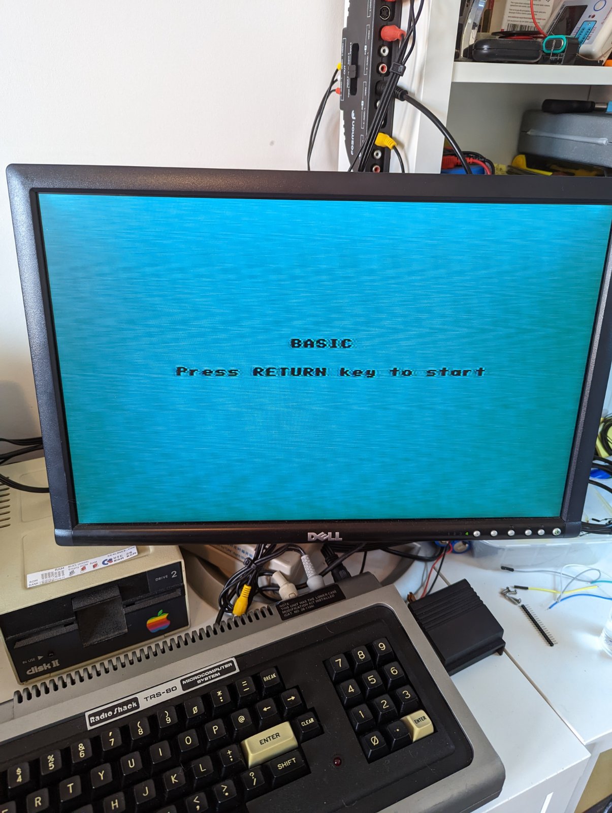

Well, the parts arrived yesterday and I built up the comp mod board and installed it into the Aquarius:
It's very well designed in that it perfectly fits in the spot where the modulator was. Apologies for the green hook up wire, but I wanted to test and the cable won't be here until this evening, so I lashed up a test rig.
The picture on this particular monitor isn't great (All composite is a bit fuzzy on this) but sufficient to see it's working just fine :)
Good result :)
