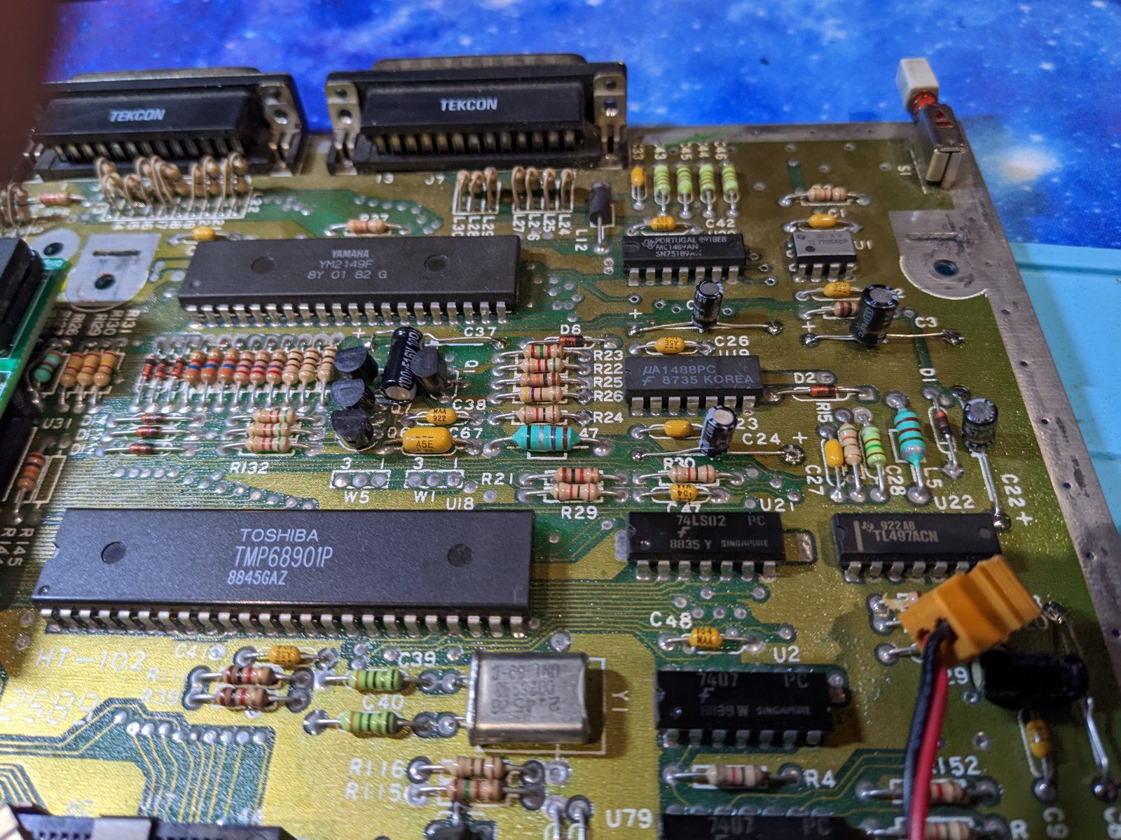

This is a Mega ST4 with C100167-001 Rev B motherboard
a02 motherboard overview.jpg (649.65 KiB) Viewed 1757 times

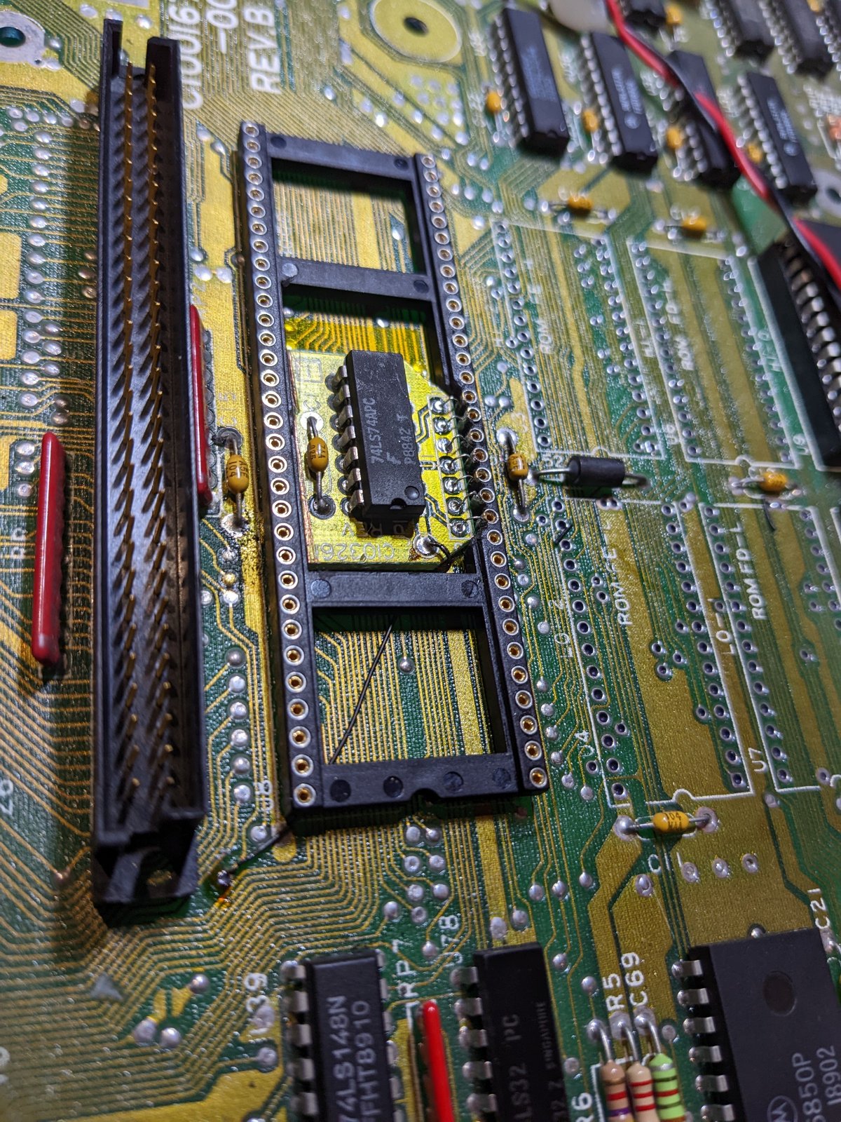

I'm going to attempt to fit the blitter patch board INSIDE the CPU socket, here I am chipping away at the plastic between pins 12-18.
a08 chip away to pin legs.jpg (436.71 KiB) Viewed 1757 times
Blitter patch before fitting
a09 blitter patch before fitting.jpg (478.19 KiB) Viewed 1757 times
Blitter patch fitting nicely in the area
a10 blitter patch fitting.jpg (468.49 KiB) Viewed 1757 times
Now I carefully add wires to the pins
a11 wiring up blitter patch.jpg (457.91 KiB) Viewed 1757 times
Now the blitter patch is fully installed within the CPU socket
a12 blitter patch installed.jpg (440.95 KiB) Viewed 1757 times
Here is another photo angle of it installed
a13 blitter patch installed 2.jpg (558.63 KiB) Viewed 1757 times

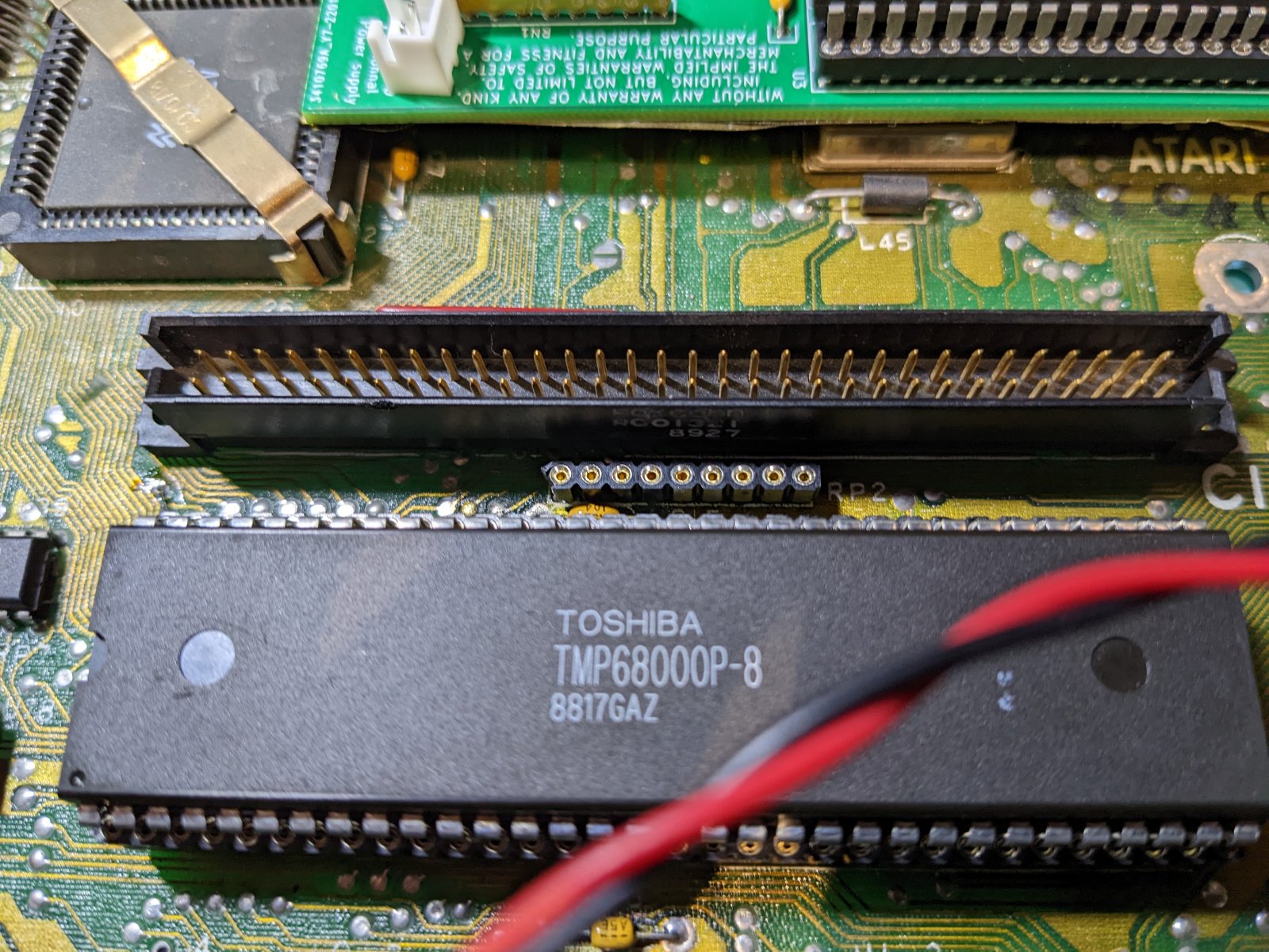

I was kind of hoping that there would be enough clearance for the CPU to fit in with the blitter patch board underneath it. This didn't turn out to be the case, so I added another layer of turn pin socket headers to give the CPU enough clearance.
a14 add height to cpu socket.jpg (499.78 KiB) Viewed 1757 times
CPU re-installed
a15 cpu installed again.jpg (516.8 KiB) Viewed 1757 times
