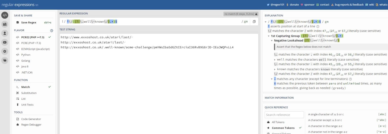

RedirectMatch 301 ^\/((?!\.well\-known\/).*)$ [THEIR_REDIRECT_TO_URL]

Also, why do these regex testers never do anything ?!
