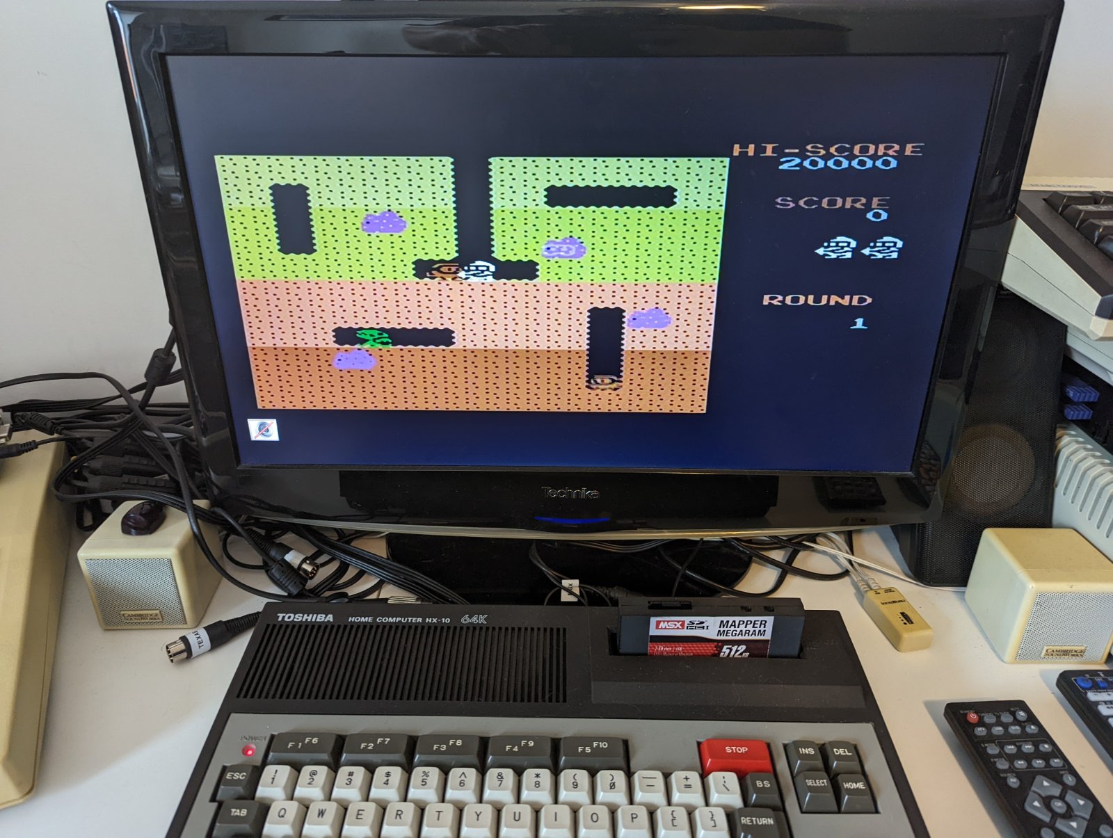

Here is a ROM (Dig Dug) executed directly from the Sofarun environment:
