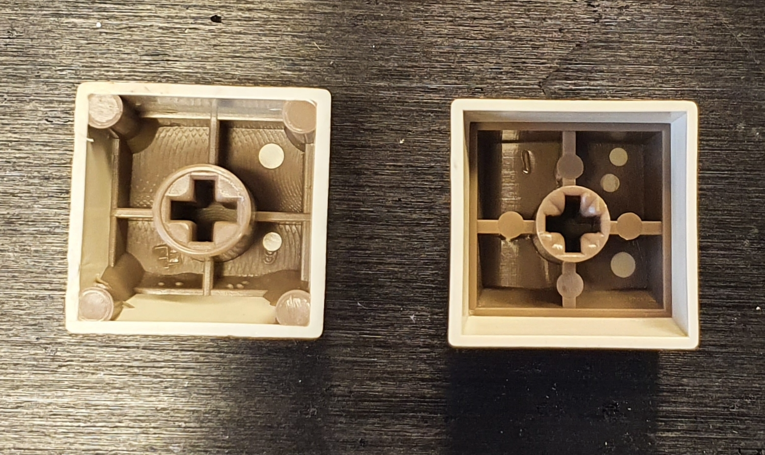

Yup. Keycap on MegaST is cherry black. The cap from normal keyboard is to big so it will wobble on the stem. The pic below show the normal to the left an MegaST cherry to the right.
