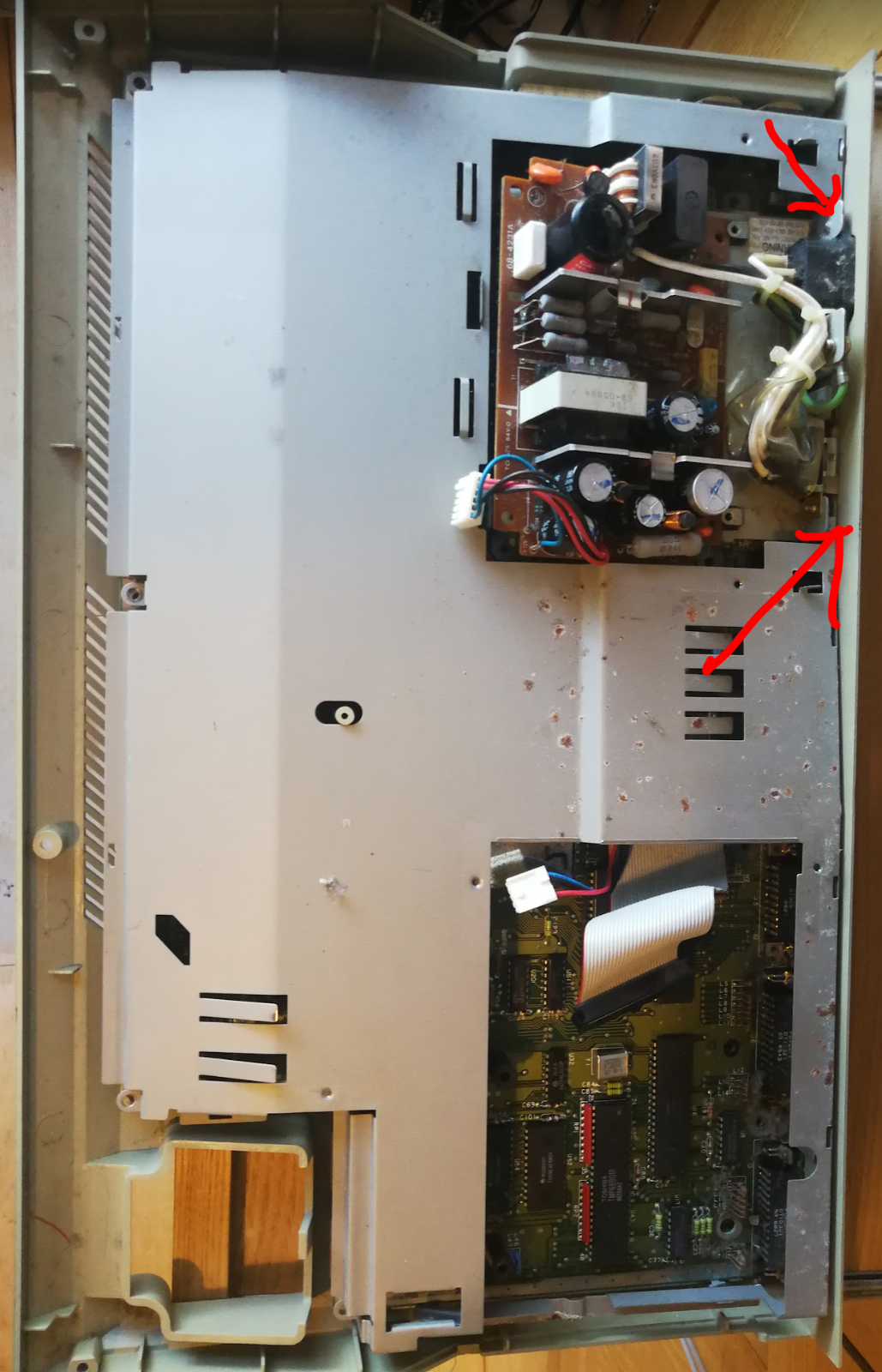

Well, I've fallen at the first hurdle. Can't get the metal shielding off.
I've unscrewed every (accessible) screw, and straightened all the tabs that hold it on. Here's what it looks like now:
Three of the corners come up nicely but there is something holding it down near the power connector, at the red arrows.
I've pulled it hard enough to bend it (slightly) as you can see, it's not budging.
OK, I worked it out eventually, need to shimmy the whole motherboard forwards to get the shield around the power switch.

DoG
- Posts: 1319
- Joined: 07 Apr 2018 12:26
Re: Where to start with my broken ST?
The PSU needs to come out first. It is fasten with 2 screws.
