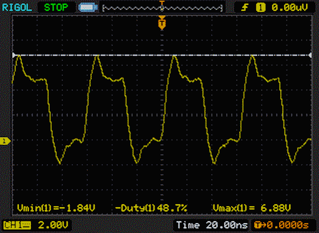

Take the analysis of such a clock patch on the FPU clock.
What we see here is a overshoot of over 8 volts (should be 5volts) and a undershoot of almost 3Volts. This can indeed be extremely damaging to connected chips.
Similarly on the SDMA end of the trace we have a even bigger problem.
Generally this ringing & over/undershoot, which I'll just call "noise" from here on out, is clamped by adding a small value capacitor around 100pF value or clamping it with a low value resistor. But it generally does not fully solve the problems and can result in a lower voltage clock signal. This can indeed greatly help the the SDMA clock end of the trace, but the FPU end will likely end up at a much lower voltage and can even cause FPU malfunctions.
Another problem which I have witnessed on some Falcons is that the logic low level on the SDMA clock is basically dependent on the undershoot of the signal rather than the signal's actual logic low level. The undershoot is generally on the order of 5-10ns and does not stay low long enough for the SDMA to register correctly a logic low level. The later revisions of the exxos V2 clock patch solve this problem by re-biasing the voltage levels so that the undershoot is actually undershoot from 0 volts, as it is supposed to be. The logic low level is thus corrected.
You can actually end up with something like 2v DC offset between the clock source and destination. So if the "logic low" is 2v, you're not at a logic low at all. So when it's crowbarred with a very low resistors such as 47R, it's literally forcing the DC offset down to more like 1V and "mostly" the voltage swing is high enough to still push a logic high over 2v. Basically it's sacrificing logic high voltage for more logic low voltage, while limiting the clock's peak to peak voltage. Not good basically!
However, on my two Falcons, 47R clamps the clock down to more like 0.5v (logic high!) and that's not enough by far, hence then my Falcon won't boot as its SDMA clock is basically low all the time.
So while low values such as 47R are classified as a termination resistor, which is true, it is actually crowbarring the DC offset of the clock line back down towards "normal" logic levels. It also concerns me that 47R by itself could draw up to 100mA! I seriously doubt the Combel could push that current by itself or various buffer/inverter ICs. Hence why I have been recommending for years that such a low value is simply not used.
