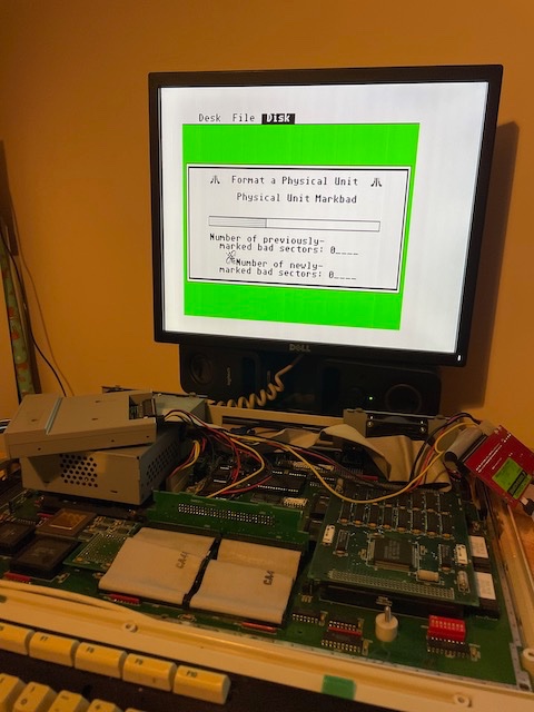

TT Continued
The TT keyboard arrived so I plugged it and an old third party mouse I had knocking about in, and everything seemed to work OK. In the meantime I had downloaded the AHDI driver and connected up my SCSI2SD and Gotek - it picked the drive up straight away but didn't seem to like 256MB partitions much so I put 2x128MB ones on there after formatting, then figured out how to install the driver etc to get it self booting.
